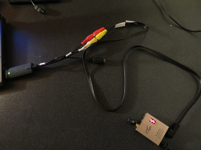

I connected this receiver to an EasyCAP USB Video Capture Adapter with the UTV007 chipset:
With this setup, I do get a video stream, but a really crappy one. Here is an example image from the stream:
There is a big gray stripe. The stripe is always present but not stationary when I move the camera. The colored areas show that the camera is working at least partially. For instance, I can see a little of my finger when I move it in front of the lens, but it's distorted.
The setup is a bit hard to debug, because all components are untested. So the problem could be anywhere between the camera and the EasyCAP. I tried different channels. For the transmitter antenna, I tried the one that comes with the Altitude RC and also the Cloverleaf one that can be seen in the picture. Same result for both.
I think the problem is not on the software side of the receiver, since I tried both VLC on GNU/Linux and EasyCAP viewer on Android with all possible settings and got the same video stream on both.
Can anyone here tell right away in which part such a problem most likely originates?

Hi Arno,
I'd recommend to try to isolate the problem first.
Fred
- Did you try to use the EasyCAP with some other video input to make sure that it works?
- What does the screen show if you just disconnect the camera? (should be noise without any distortions)
- Maybe you can also try to hook up the camera directly to your EasyCap? (Be careful!)
- Do you have a friend or a friendly RC shop that would allow you to test your setup with a different receiver (e.g. Fatshark googles, FPV monitor)?
Fred
Re: Debugging FPV setup
Hi Fred,
Thanks a lot for your recommendations! The FPV setup works fine with Fatshark goggles, so the error is definitely on the receiver side. It must be the EasyCAP or the mini FPV receiver. I didn't have an opportunity yet to try the EasyCAP with other analog input and I could not hook up the camera directly to the EasyCAP, so I cannot tell yet which of the two it is. When I disconnect the camera, the screen indeed shows only noise without any distortions.
To conclude this, it was the mini FPV receiver being faulty. The EasyCAP works fine when getting input from the Fatshark goggles.
