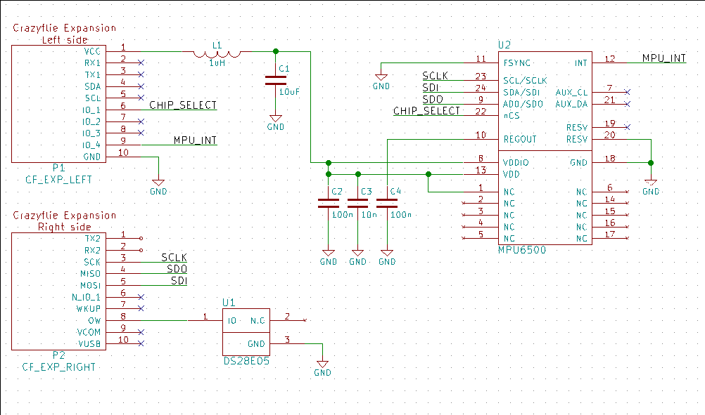

Post by tobias » Wed Jun 29, 2016 9:34 pm
Would this work maybe? ;)

Post by Maxzor » Tue Jul 05, 2016 8:19 am
Looks great, but after having been busy migrating some racer builds to betaflight and raceflight, you might prefer to hold on for now...
I will see if I am able to do something with the current hardware configuration : 8kHz gyro interrupt is already something :)
