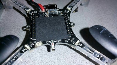

Is there someone that repairs crazyflies. I have had mine a couple weeks and was able to damage the on off switch. I don't know if this is repairable or not. Any information would be appreciated.

Looks like the switch piece became jarred from the housing. Maybe I just need to find out where to get this switch from. anyone know?

You can find a list of replacement parts here: https://wiki.bitcraze.io/projects:crazy ... spareparts. The switch is SW1.
Re: Crazyflie Repair
It's not too hard to replace. A little soldering experience will help. The surface mount switch takes a good eye so a magnifier is a big help. I blogged about it once. I found the switches at Mouser.com (links in the blog post). You an also just use a piece of metal or a wire to momentarily short the two sides of the button (where the solder pads are) to turn it off and on.

thank you very much for your help. I'll be buying a few switches and get on this repair shortly.
