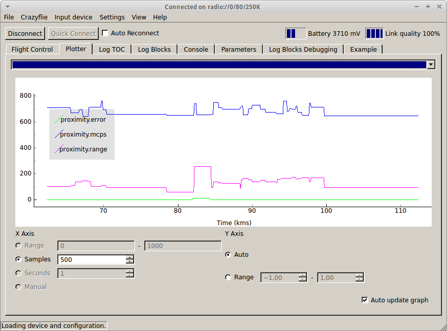

Thanks Tobias!! Check out the attached image. Looks like the sensor is reading!
Like you said, it looks like it needs a bit of fine tuning but at least I know it works now. The goal is to use the sensor to have a very controlled hover, so it needs to be working optimally.
Re: Heightsensor VL6180
Great! Looks like you have similar behavior as I have. It does not read anything close. I guess it is a configuration thing, however I don't have any time to look into that right now so I'll leave it to you
