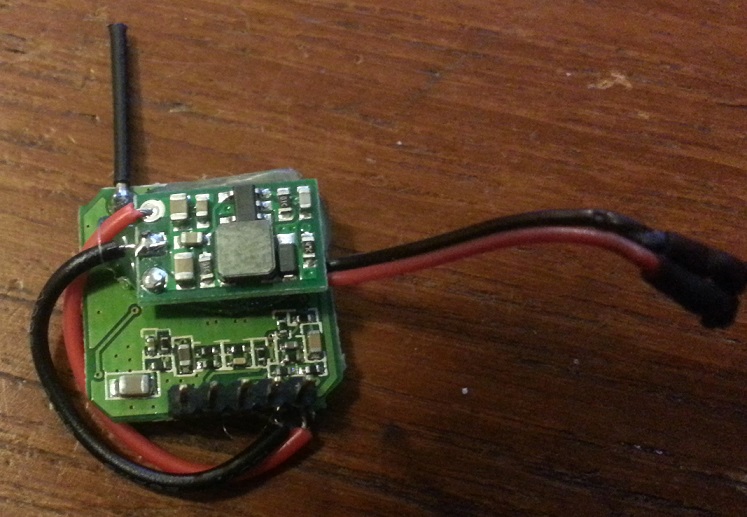

Used your thread to put together my first FPV system, nothing fancy, no camera mounts (aside from blue-tac) but seems to have come together quite well.
Defiantly onto a winner with the 5V Step-up.
I have horrible luck with photos and the internet so don't know if these will show up but I've attached what i put together based on your work and it all fits together really nicely. I'm using the connection from the headers on the transmitter to act as a mounting point for the camera, at the moment i just have a bit of blue-tac holding the combined camera+transmitter to the board while the cable goes up and over onto the jtag connections.
anyway, wanted to say thanks for putting up a good build page... i doubt i would have known about the voltage issues (Bit of a noob) and probably would have fried a few components before i put it together right.

Hey onextw,
Thank you too for sharing! Its great to know I could help, thanks for the effort of contributing here![:-) :)](./images/smilies/icon_e_smile.gif)
Your pics came through great - youve done a much cleaner job of attaching it all together than I have!
I made some 3d prints, they should arrive tomorrow. Before you go on figuring out how to attach it all, wait a few days and I can let you know if any of the models turned out well. With any luck one of the combinations (tolerances, dimensions etc) should work out and you can order a camera holder from shapways..should be around 5€ + shipping.
Im a total n00b when it comes down to electrical engineering too, Im a pure computer science guy. Choosing that voltage regulator was mostly luck, I had similarly spec'ed ones that didnt work.
Glad you like the HUD!
I dont think Ill have a public version of that available any time soon...too many dependencies, etc and its very tailored to my needs/environment (modified ros packages, etc). If you really wanna give it a try we can work something out. Around the end of the year I hope Ill come up with a modified crazyflie VM that includes the HUD, various input devices andt more advanced things like position hold etc.
Let us know what kind of battery life / ranges you are getting!
