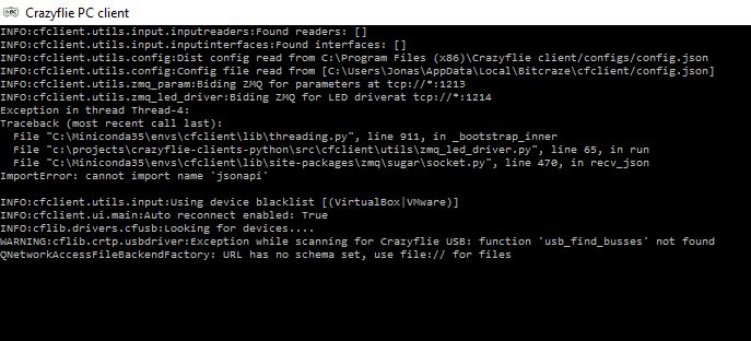

In the Debug window from the Client shows me following interface Status:
Interface status
UsbCdc: No information available
udp: None
radio: Cannot find a Crazyradio Dongle
serial: None

Hi joenten,
Have you installed the Crazyradio driver with Zadig: https://wiki.bitcraze.io/doc:crazyradio ... dows_zadig?
