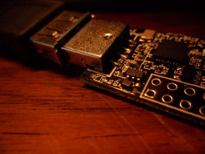

My radio dongle crazyradioPA stopped functionning.
I saw that the D1 diode was missing ?
I wrote to Seedstudio...

I definitely have a D1 diode on my Crazyradio PA!

Hello Chad
Is it a problem if the D1 diode is suppressed ? That means replaced by some small wire.

No problem as long as you don't power it from the expansion port at the same time.Is it a problem if the D1 diode is suppressed ? That means replaced by some small wire.
Re: CrazyradioPA stopped
Thanks very much.
