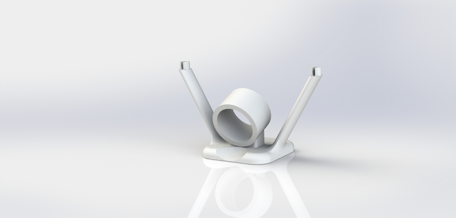

I have been working on a similar project for the Crazyflie 2.0. Here is a picture of my camera mount design for the 0.6g camera available on the FPV hobby website for the Crazyflie 2.0. If anyone is interested I am happy to provide the Solidworks files so you can print one yourself and or modify it to your liking. Please note that you must be using the wide angle lens for this mount to work correctly.
