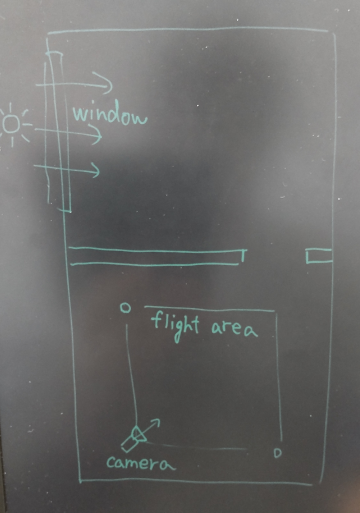

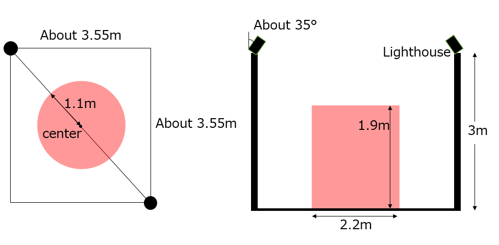

this is the flight area environment.
the red area is the flight range of the crashed or unbalanced crazyflies

It is a bit difficult to see where these crashes come from... It can be perhaps due to bad batteries, wind of the propellers of the other drones or perhaps you are flying to close to the top of the lighthouse basestations. But let's figure it out!

- The bright open door in the back, is that direct sunlight?

2. The video was taken in 15:00~19:00. it is sunlight and fluorescent light. 3. all crazyflies and lighthouse decks are flushed the 2021.03 firmware from cfclient

2- That should be okay but it might improve if you close the door.
