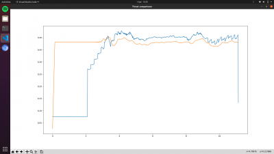

I have a question. I have calculated the thrust via the formula provided in the paper and the signal logging of pwm.m1_pwm (the motor pwm compensated for battery voltage). This is the blue line seen in the graph. The orange line is using the accelerometer data from the body z-axis and uses f=m*a to calculate the thrust.
What can be noticed is that there is an offset between the lines, this offset seems somewhat constant. What could cause this? As during hover I expect the engines to produce the thrust equal to 1g of acceleration. (and thus the lines needing to be almost equal).
The graph shows force in Newton on the y-axis and time on the x-axis. The hover flight starts around 4 seconds and lasts 5 seconds.

I can think of multiple reasons:
1. Unbalanced rotors, i.e., during hover your PWM is actually not the same for all motors. You can look at m1-m4 and apply the transformation to each of them.
2. Numerical issues. The paper only shows 2 digits. Here are the full parameters:
C_00 = 11.093358483549203
C_10 = -39.08104165843915
C_01 = -9.525647087583181
C_20 = 20.573302305476638
C_11 = 38.42885066644033
3. Worn out motors/propellers. I haven't really seen this in practice, but the data provided in the paper was only checked with 3 different Crazyflies (& different batteries). I think the only way to address this, would be to build a force stand. We are in the process of building one at Bitcraze, which is an improved version of the one that I built for the paper cited earlier. You can find some preliminary documentation and analysis scripts at https://github.com/bitcraze/crazyflie-f ... /README.md.

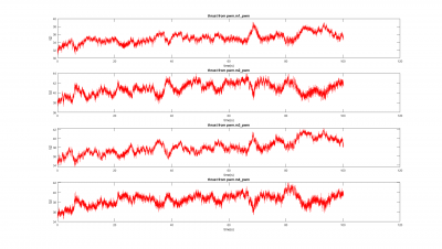

I have done following experiment: I let the Crazyflie hover for 100 seconds, and I logged the stabilizer.thrust(this is thrust percentage mapped to a uint16_t, where 0 is no trust and 65535 is full thrust.). I used following formula to calculate the thrust (the unit is g, according to your website, the total thrust is about 60g):thrust = (thrust_ratio/65536)*60. Therefore, I can get the mean thrust is about 37g, but if I use a Electronic scale, the weight of the crazyflie2.1(include the markers which is use for motion capturing) is 32g. so there is about 5g error, is this an acceptable error?
I also logged the pwm.m1_pwm to pwm.m4_pwm(this is pwm percentage mapped to a uint16_t, where 0 is no pwm and 65535 is full pwm.), then I used the relation about PWM vs thrust from here(pwm vs thrust: thrust(g) = 0.409e-3*pwm^2+140.5e-3*pwm-0.099, in this formula, the pwm is represented by 8bit value):https://wiki.bitcraze.io/misc:investigations:thrust. of course, before I used this formula, I convert the pwm percentage from uint16_t to 8 bit.
I put the thrust vs pwm plot in the attachment. According to the plot, the thrust from each motor is different, also they all greater than 30g(if this is true, the total thrust is greater than 30*4=120g? I don't believe that). is there anything that I do it wrong?
Thanks

The battery voltage will influence how much thrust the motors can generate and I think this is one of the major thing that you see here. 60g thrust is only true for a fully charged battery.
The graph you are referring to is showing the combined thrust of all motors, thus should be divided by 4 to get single motor thrust.
