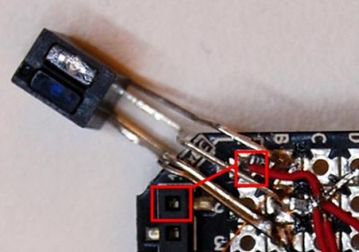

1.Is this resistor "Thick Film Resistor" used"?
If that used, Can I change the "Carbon Film Resistor" generally?

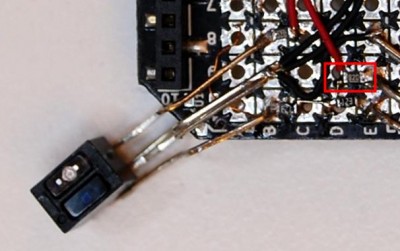

2. In Prototype deck, If I solder in 1(row)-A(column), Is hole 1-A connect with pin 1 automatically?

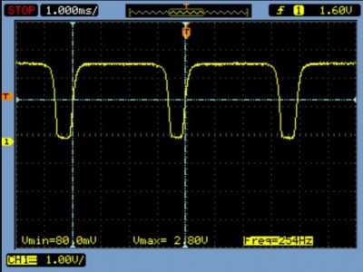

3. What do you use scope program in the post?
Posts: 2122
Re: To.tobias : Question about "Measuring propeller RPM: Part 1”
I will try to remember :-)
1. Yes you can use Carbon Film resistor instead
2. Yes
3. To verify the output from the sensor. That it detects the spinning propeller and that the signal looks good.
