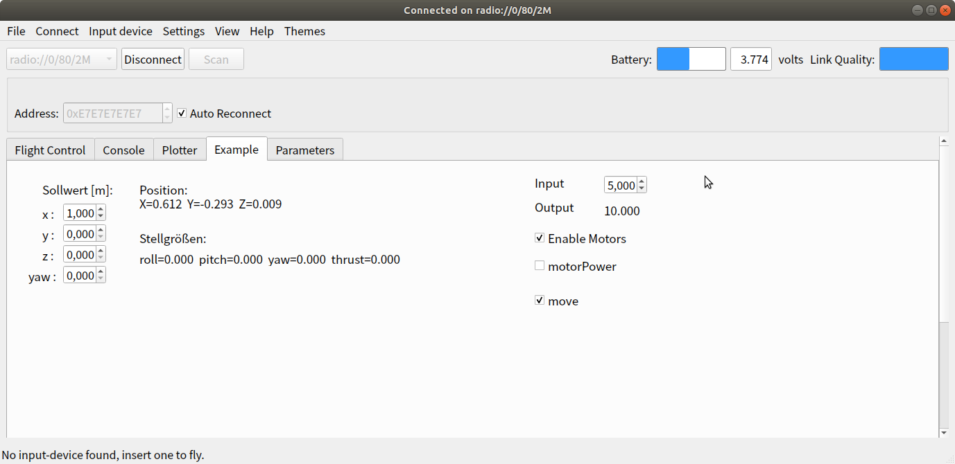

Hallo,
i can control the Crazyflie using Lighthouse system, but only with the python code, for example https://github.com/bitcraze/crazyflie-l ... equence.py. Now i want to write a new Client-Tab for controlling with LH. I know how to read and change the parameters in new Tab after i learned the Logging and parameter framework video https://www.youtube.com/watch?v=chWrNh73YBw. Now I want to add some features, such as logdata read and setpoint.
My problem is:
1. I tried to write the Tab based on the QualisysTab, but unfortunately, I can only complete the log reading function, but can't make the copter take off with sentpoint function.
2. After I wrote the new log reading function, all the parameters in ParamTab are locked in red and i can't modified them any more.
Does anyone have experience in this area, can you give me a simple template?
here is my code und the new Tab:

Sounds like a nice project.
For your problems:
1. I think you should look at this ticket: https://github.com/bitcraze/crazyflie-c ... issues/334. To be able to control the Crazyflie from a tab you need to disable the gamepad control, I added a function to do that in the ticket. Once the gamepad is inhibited, you should be able to control the Crazyflie form your tab the same way you are doing it in standalone python scripts.
2. I have no idea how this could happen, the log and param subsystem should be pretty independent and you should not be able to disable the params that way. Could you isolate what what triggering this effect?
Unfortunately I cannot test the tab since I do not have the .ui tab, so if you send it as well I could test it.

thanks for your reply!!! now I know how to solve the problem, although i don't know why.
The LogConfig() period should not be smaller than the "ui_update_period" , which means it should not be smaller than 100 ms. Is it possible to make it smaller?
