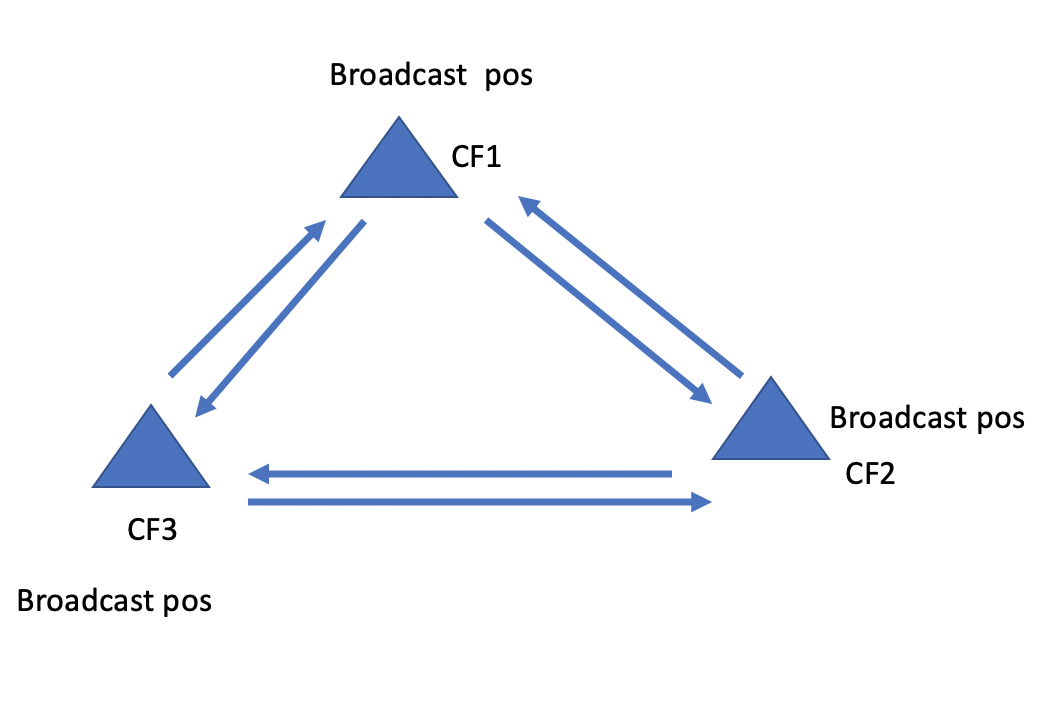

p2p communication is like all CFs in mode broadcast, there is no reply, for example, if CF1 sends a message to CF2 and CF3, CF2 and CF3 cant reply!
what I understand, it does not be, as ESB protocol is like a star network topology, only one receiver, and transmitters. I don' t know if I'm correct?
like in this figure!
Posts: 790
Re: Crazyflie_Communication_between each other
Post by kimberly »
Broadcast mode does not wait for the reply of others (ACK). If you just send it every once in a while, or have a time.sleep() with different times based on the crazyflie IDs, that will be fine untill up to 6-7 crazyflies. Otherwise you can also implement some kind of round robin style (CF1 starts, CF2 sends next after receiving from CF1, CF3 goes next).
The p2p functionality is still basic so you will need to implement the timing protocol yourself. However, there is now an applayer example in the crazyflie-firmware repository to get started (https://github.com/bitcraze/crazyflie-f ... er_to_peer).
