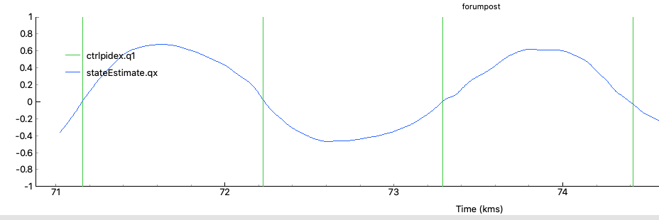

Then, the controllers use the information as necessary. However, when logging the output of the state information directly from the controller script, the values seem to change drastically. I tried logging some state information from controller_pid.c and controller_mellinger.c to see if I made a mistake, but they were outputting the same conflated values. The controllers are all working fine, so I assume that I am somehow accessing the variables incorrectly when logging. I should note that the same state values are all outputted properly in the stateEstimate log block in stabilizer.c.
This picture shows the output of q1 (quanterion) from the the stateEstimate log group as I rotate the crazyflie, and it looks as expected:
This picture shows the output of q1 from the log group in controller_pid.c as a I rotate the crazyflie.
If you notice the y axis, the values have become huge, on the order of 10^9. Also, its hard to see in the picture, but if you look really closely, you can see that the value is changing as I rotate the crazyflie. It also jumps around +/- 10^9. This all leads me to believe that I am accessing the correct variable, but I am somehow scaling/changing it from what is originally in the state variable.

Could it be that you are defining the same log group in two files. Can't remember if this creates a compile error or not...
I tried quickly to replicate it but could not. I created it a bit different though with a static float q1 which I copy to from the state_t struct.

    cmd_roll = control->roll;
    cmd_pitch = control->pitch;
    cmd_yaw = control->yaw;
    attitudeControllerResetAllPID();
    positionControllerResetAllPID();
    // Reset the calculated YAW angle for rate control
    attitudeDesired.yaw = state->attitude.yaw;
LOG_GROUP_START(controller)
LOG_ADD(LOG_FLOAT, cmd_thrust, &cmd_thrust)
LOG_ADD(LOG_FLOAT, cmd_roll, &cmd_roll)
LOG_ADD(LOG_FLOAT, cmd_pitch, &cmd_pitch)
LOG_ADD(LOG_FLOAT, cmd_yaw, &cmd_yaw)
LOG_ADD(LOG_FLOAT, r_roll, &r_roll)
LOG_ADD(LOG_FLOAT, r_pitch, &r_pitch)
LOG_ADD(LOG_FLOAT, r_yaw, &r_yaw)
LOG_ADD(LOG_FLOAT, accelz, &accelz)
LOG_ADD(LOG_FLOAT, actuatorThrust, &actuatorThrust)
LOG_ADD(LOG_FLOAT, roll,      &attitudeDesired.roll)
LOG_ADD(LOG_FLOAT, pitch,     &attitudeDesired.pitch)
LOG_ADD(LOG_FLOAT, yaw,       &attitudeDesired.yaw)
LOG_ADD(LOG_FLOAT, rollRate,  &rateDesired.roll)
LOG_ADD(LOG_FLOAT, pitchRate, &rateDesired.pitch)
LOG_ADD(LOG_FLOAT, yawRate,   &rateDesired.yaw)
LOG_GROUP_STOP(controller)
LOG_GROUP_START(crtstate)
LOG_ADD(LOG_FLOAT, q1, &q1)
LOG_GROUP_STOP(crtstate)
PARAM_GROUP_START(controller)
PARAM_ADD(PARAM_UINT8, tiltComp, &tiltCompensationEnabled)
PARAM_GROUP_STOP(controller)
bma
Posts: 2
Joined: Fri Jun 19, 2020 9:45 pm
Re: State estimation values for controller seem incorrect
Post by bma » Wed Jul 01, 2020 10:13 am
I figured out what the issue was! I had set the log group variables to type PARAM_FLOAT instead of LOG_FLOAT accidentally. (Oops :cry: )
LOG_ADD(PARAM_FLOAT,q1, &q1)
Thanks for the help!
