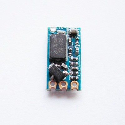

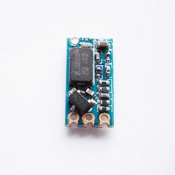

The S7V8A might be a good and simple solution. It even has an easy accessible enable/disable pin.
If you would like to change the nano TX regulator it is the one marked 662K on the back side of the TX. Found this datasheet. The S7V8A is probably the best to start with though

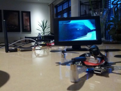

Tonight I was successful in integrating the Sub-Nano camera from FPV Hobby onto the Crazyflie.
I'm using their 2.4GHz receiver module and an Adafruit 4.3" LCD. Also using the Raspberry Pi headless client.
Soldering the camera and transmitter wires was a bit of a task, but the result is a very tiny FPV system with absolutely *stellar* video quality. The demo video on the FPV Hobby site is not an exaggeration. I've also opted to use the same chip antenna as the CF on the video transmitter to cut down on size and weight. With the standard Rx antenna, I'm able to get stable feed at 20m range indoors, and choppy video to 35m. Tomorrow I'll do a flight-time test to see how many minutes I can keep it in the air.
I'll be looking for a better antenna shortly as well as a video capture dongle so I can upload a demo video.
Here's a pic is the setup (yes, I used electrical tape to hold the camera )...
