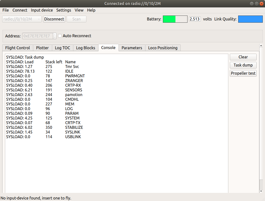

Post by tobias » Fri Aug 09, 2019 1:27 pm
Thank you for well written problems. In summery, it sounds like some of the problems can be related to "Flow deck and Loco deck in TWR mode makes Loco deck hang" bug and there is a potential solution described there, but I don't think that is the root cause, just a way to relax the uwbTask. I think more of a bug in the dmw1000 driver state machine that we have been unable to find yet. There is also a high probability you are seeing all sorts of new bugs when you load the system. There is a way to take a snapshot load of the system in the console tab in the cfclient. Might be worth trying to get a feeling of how loaded the system is.
