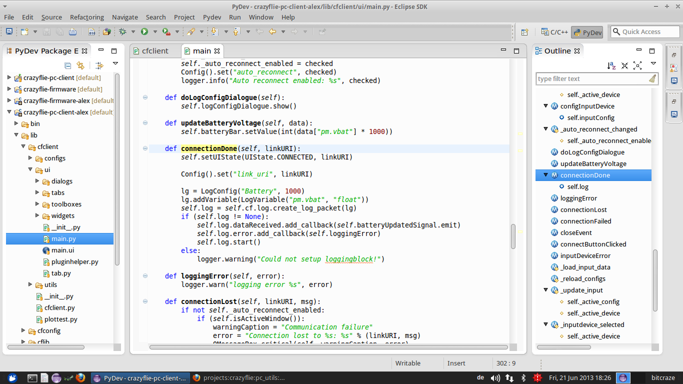

Had some very enlightening evenings - just me, TortoiseHG and the firmware/client code... :idea:
Nevertheless, can't get this to work:
main.py
def connectionDone(self, linkURI):
        self.setUIState(UIState.CONNECTED, linkURI)
        Config().set("link_uri", linkURI)
        lg = LogConfig("Battery", 1000)
        lg.addVariable(LogVariable("pm.vbat", "float"))
        self.log = self.cf.log.create_log_packet(lg)
        if (self.log != None):
            self.log.dataReceived.add_callback(self.batteryUpdatedSignal.emit)
            self.log.error.add_callback(self.loggingError)
            self.log.start()
        else:
            logger.warning("Could not setup loggingblock!")
        gyroconf = LogConfig("Gyro", 10)
        gyroconf.addVariable(LogVariable("gyro.x", "float"))
        gyroconf.addVariable(LogVariable("gyro.y", "float"))
        gyroconf.addVariable(LogVariable("gyro.z", "float"))
        self.log = self.cf.log.create_log_packet(gyroconf)
            self.log.dataReceived.add_callback(gyroData)
            self.log.start()
        else:
            print "gyro.x/y/z not found in log TOC"
    def gyroData(data):
        print "Gyrodata: x=%.2f, y=%.2f, z=%.2f" % (data["gyro.x"], data["gyro.y"], data["gyro.z"])
and
stabilizer.c
LOG_GROUP_START(gyro)
LOG_ADD(LOG_FLOAT, x, &gyro.x)
LOG_ADD(LOG_FLOAT, y, &gyro.y)
LOG_ADD(LOG_FLOAT, z, &gyro.z)
LOG_GROUP_STOP(gyro)
static bool isInit;
static void distributePower(const uint16_t thrust, const int16_t roll,
                            const int16_t pitch, const int16_t yaw);
So far I'm getting some nice graphs choosing the gyro for plotting. :D
But what about the console output of the raw gyro data using the code line above:
1. There's no console output except the default one from the copter's selt test - is anything wrong with my code?
2. Second question: is creating a log group in stabilizer.c also necessary for getting console output of specific sensor data or is it used solely for telling the client what structures can be used for plotting (log TOC)?
Posts: 2108
Re: Adding sensor data logging / general software structure
A first quick answer. The print command from python will end up in the "terminal" console and not the one in cfclient. Could it be that?
alex
Posts: 137
Location: Germany
Post by alex »
tobias wrote:A first quick answer. The print command from python will end up in the "terminal" console and not the one in cfclient. Could it be that?
Errr, yes, it could! :)
So I simply have to open a new terminal window that prints the desired values? OMG. :o :)
Any input for question no. 2? Is there a correlation between the log group command and the console output or is it only used for distributing the input for the plotter tab?
marcus
Posts: 601
Post by marcus »
alex wrote:Any input for question no. 2? Is there a correlation between the log group command and the console output or is it only used for distributing the input for the plotter tab?
Adding the log group will allow you to get the variable value on the client side though the logging framework. But if you just want to print the value using printf in the firmware you do not have to add this and the value will end up in the Console in the client.
