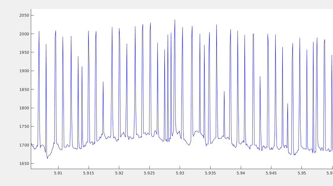

Re: High frequency streaming
Btw I'm experiencing something I believe is some kind of interference from the packet sending. Did you ever seen something like this on readings from the adc? For some reason this noise almost disappears when the ground of the Crazyflie is connected to my oscilloscope...
