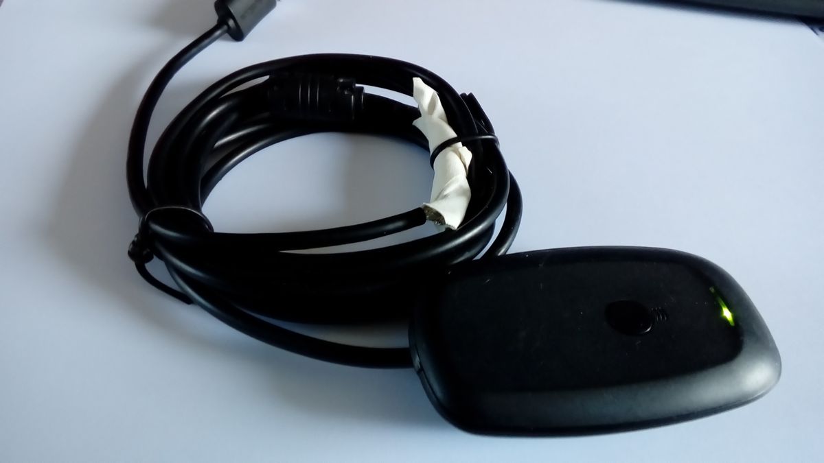

After some time, I bought windows 10 system and install Crazyflie python client. On this system:
1/ my xbox360 + receiver does not connect. I suspect my receiver is not a Microsoft one, although vendor and product are correct. See the photo. The word Microsoft is not written onto.
