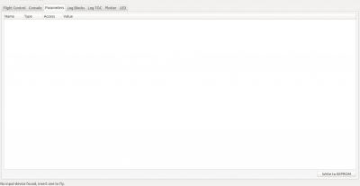

Well, I suppose you want to keep the possibility to modify the value of the parameter in the RAM as it is now, and just add the permanent storage in the EEPROM for retrieval at startup and for storage of a single value as requested.
If that is the case, I think there is little to no modification required to the GUI, since from the user point of view the new feature is really related to the already implemented one to change Params in RAM.
What I think would be easy and usable is to add a button in the Param Tab to save the values in the EEPROM. You can also keep track of which value is been modified and ended up to be different to the one in the EEPROM and send the request only for those values.
Something like this:
When pressed the button in the bottom right corner, every value modified get sent to the EEPROM to be stored.

I like the idea of keeping track of which value has been modified, it keeps the GUI implementation simple. We can add a new column with the status (unmodified, modified, stored), maybe with color code. I will try to look at it and implement the Crazyflie and protocol part.
