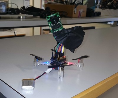

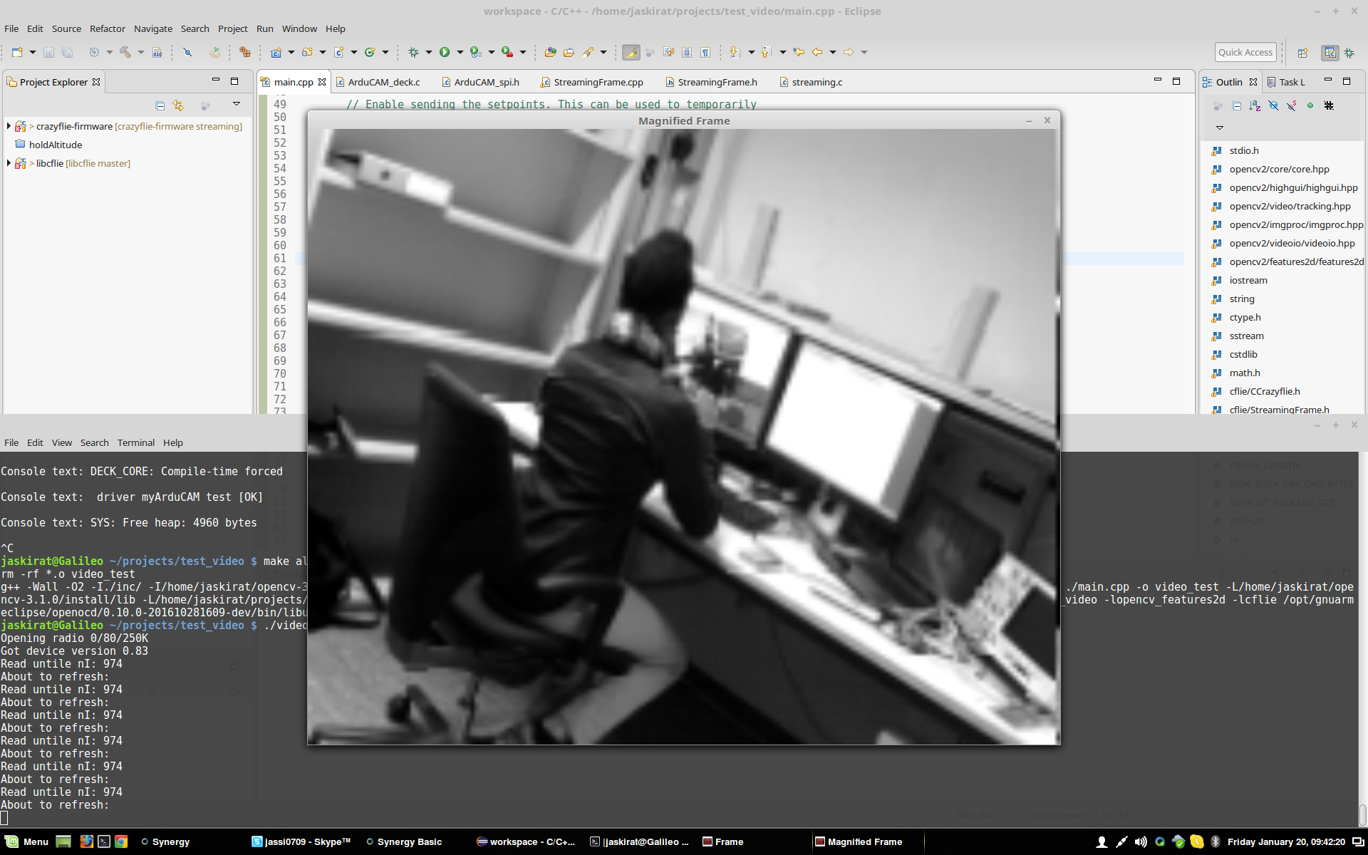

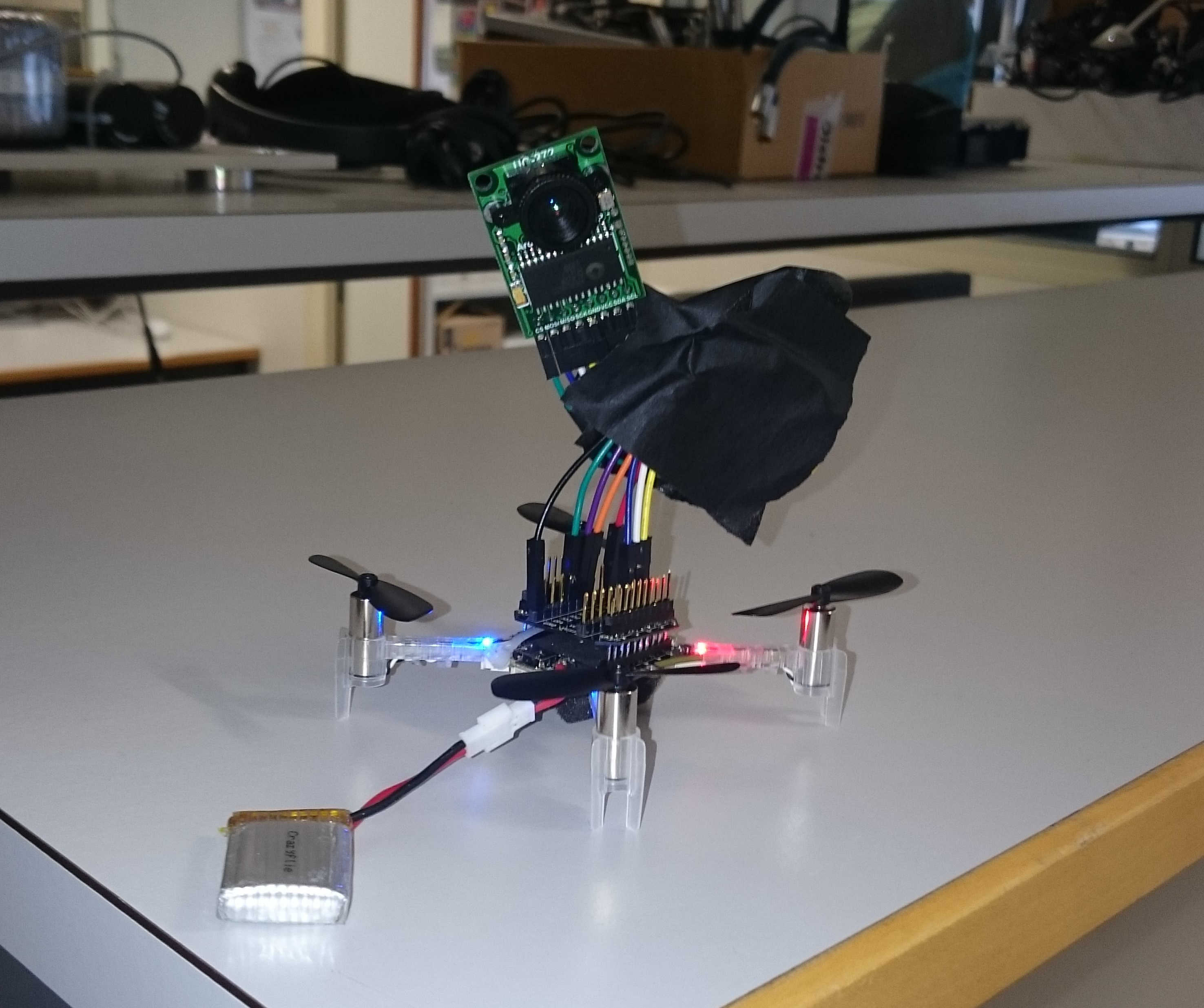

Here some pictures.

Here some pictures.

Thanks for the pictures! The camera setup looks ... interesting . Does it fly?

Hi Arnaud.
Hahahah no the mechanical part is not ready yet. I have to find a proper way to fix it and understand how to minimize the weight.
Will do that in few days.
Jassy
