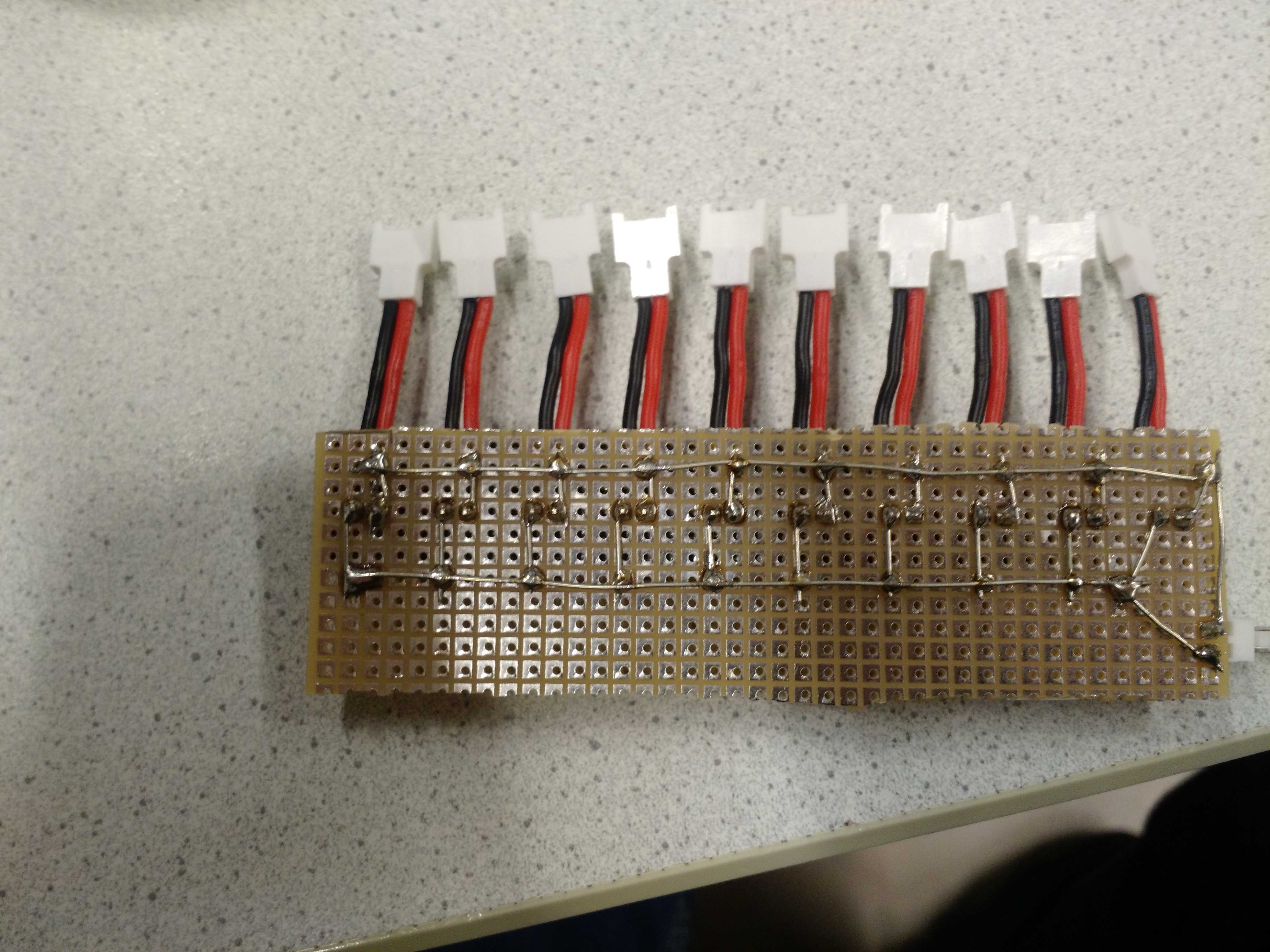

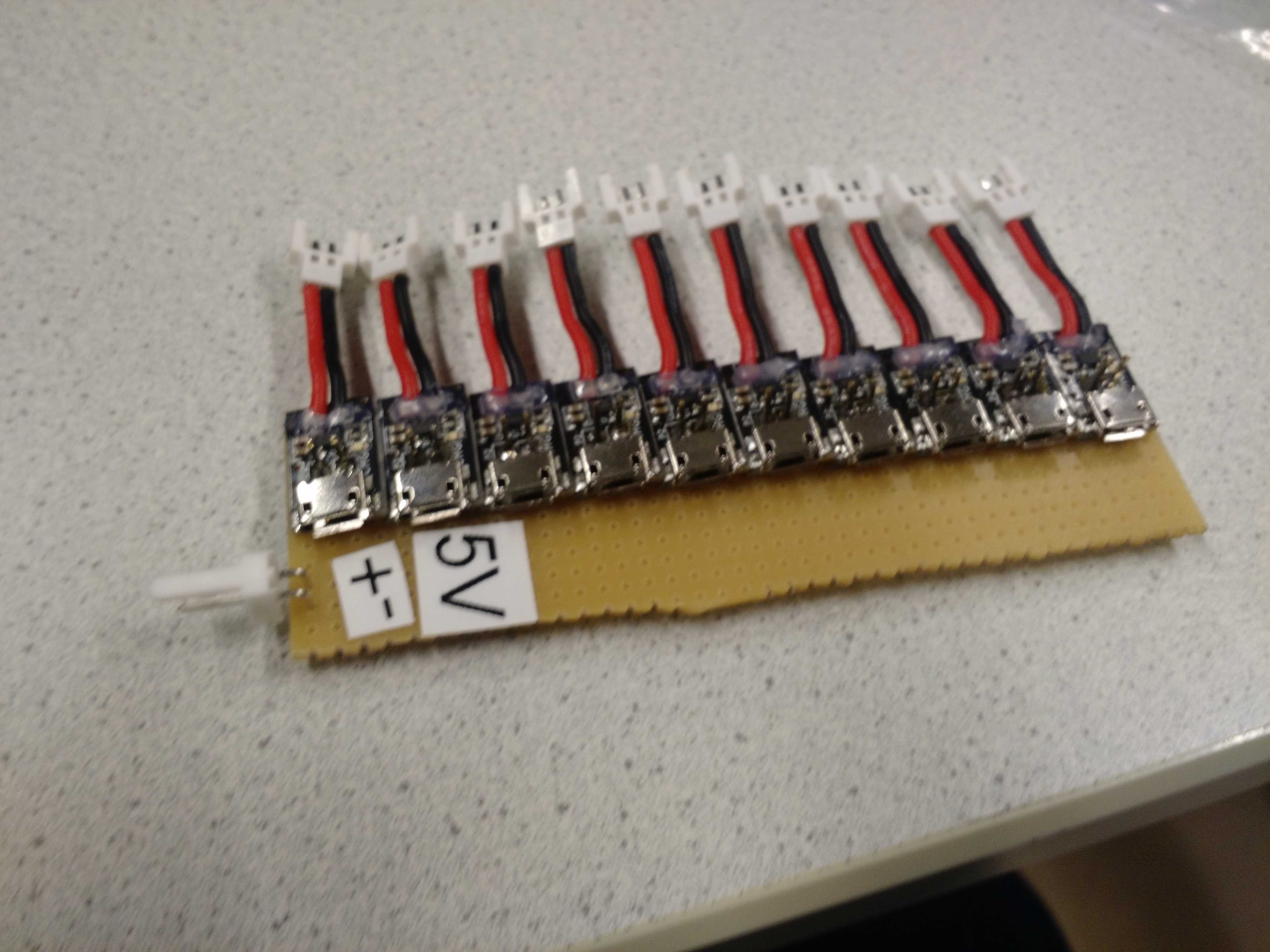

After a good week i recieved the chargers and i started connecting them.
Thanks to the schematics (and to marcus for uploading them) i was sure on how to connect them.

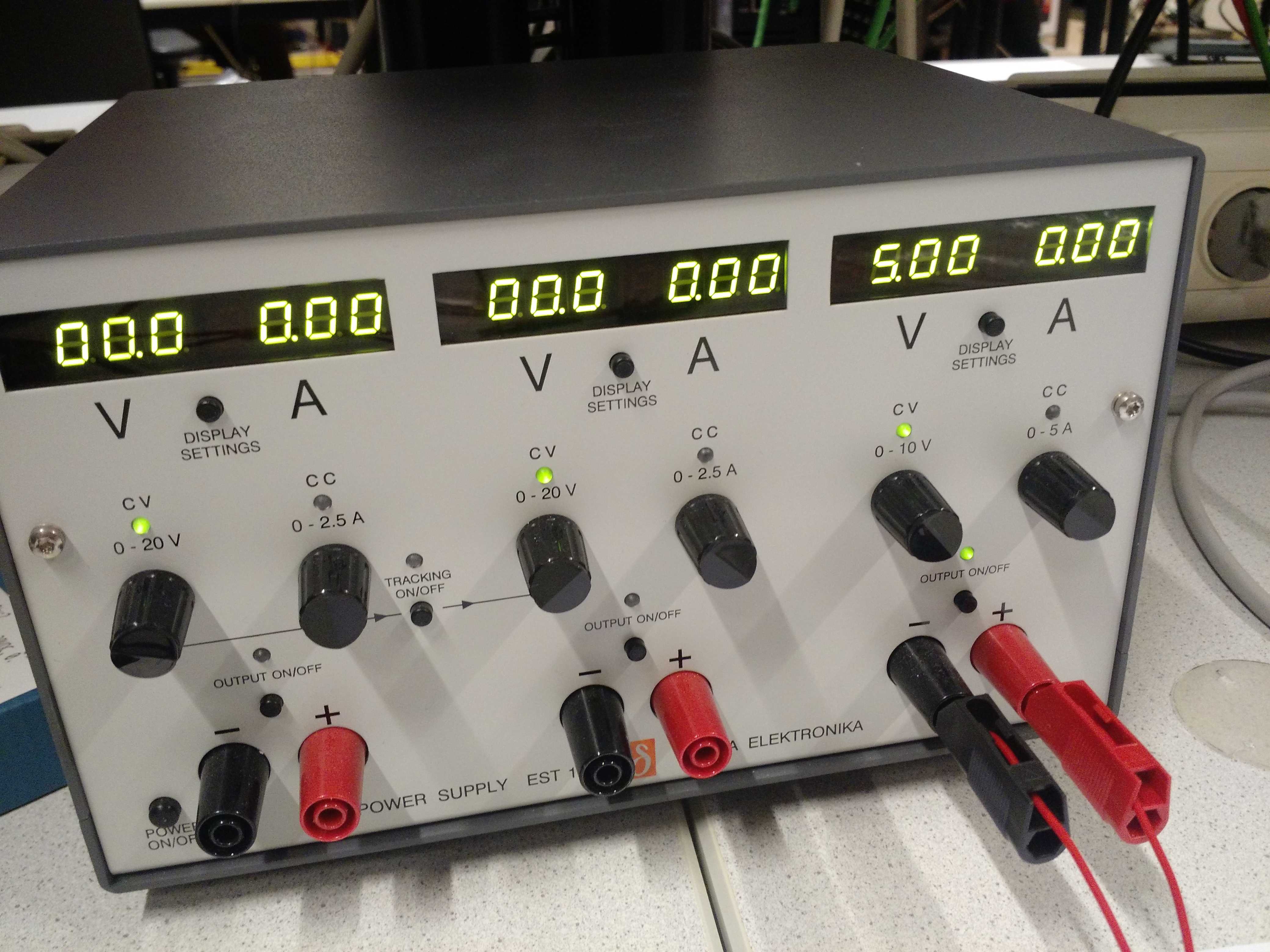

Basically, just as in your setup, i have just put in parallel all the connectory, leaving space to use the micro-usb connector but adding another connector. I didn't have available a suitable power suppy, so i used a configurable one (a delta elektronika power supply with three ports, i'm using the one that gives up to 5 A with a constant 5 V output)
Here are the pics:
Unluckly the charger are just a lil bit larger that 4 holes, that means that they do not align perfecty but overlap a little bit. What a pity.
Here are the pics:
