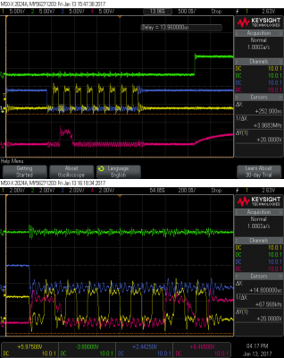

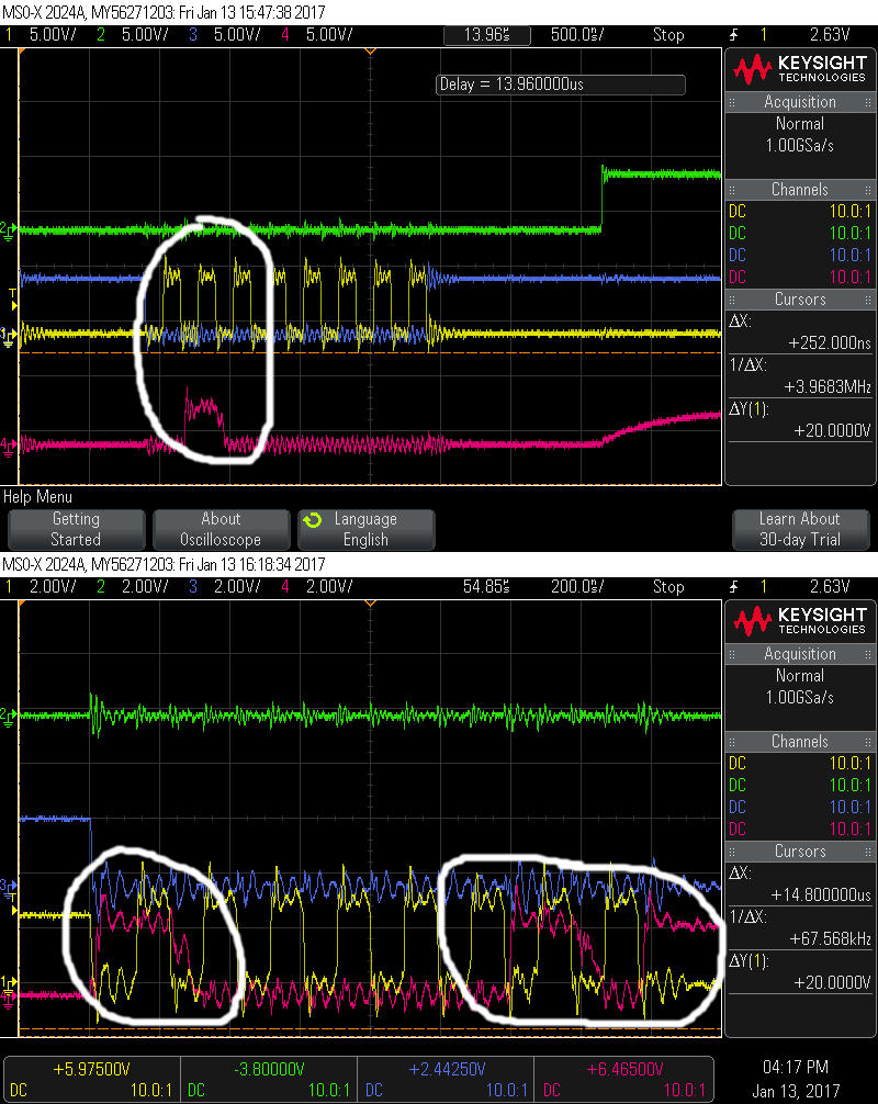

After connecting and porting the code from Arduino to STM32 SPI API, I've noticed a really strange behavior when I try to read the TEST register: I read something different from what I wrote.
Comes without saying that, on Arduino, everything is working flawlessly, while on the STM32 the camera is replying with a wrong signal ( ).

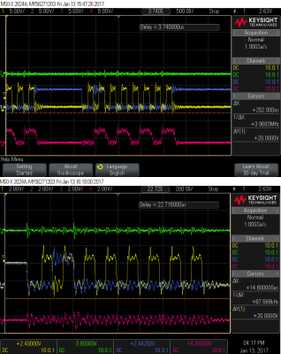

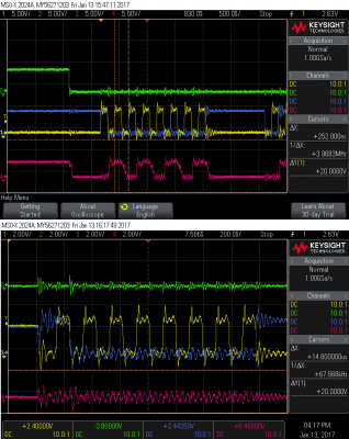

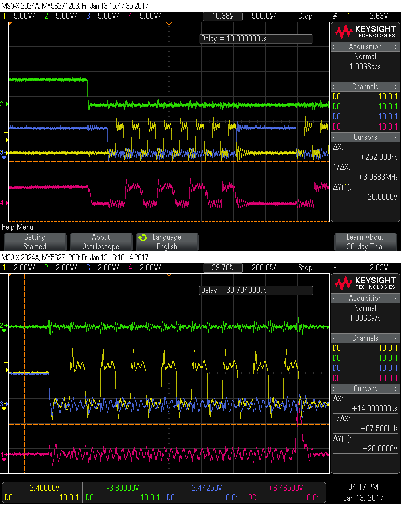

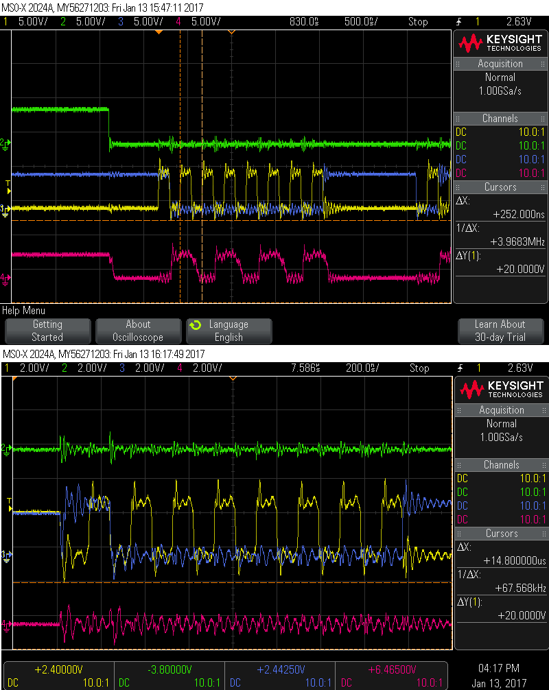

PS: In the pictures, the top oscilloscope screenshot is for from the Arduino while the bottom one is from the Crazyflie.
