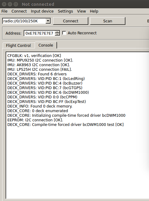

from the crazyflie-client-python, I find the dwm1000 init successfully:

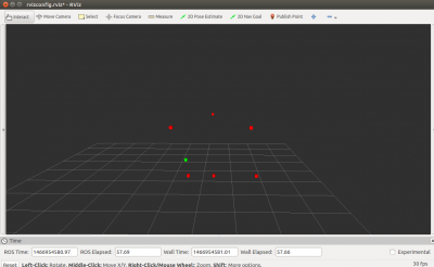

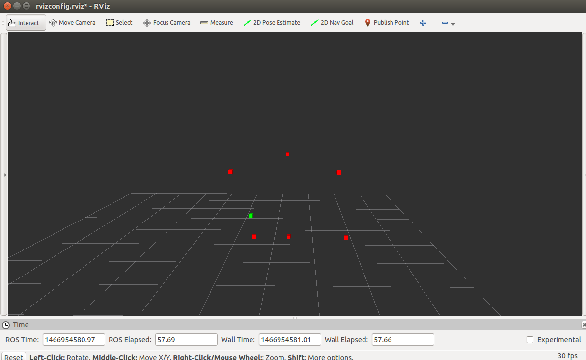

the follow picture is lps-ros, the tag have no move.

Hi justinleeyang,
The first thing is to verify that you are getting range measurement from the Crazyflie, you can do that by plotting the ranges in the Crazyflie client and/or by printing the ranges in ros using
rosropic echo /ranging
If there is no ranging you will need to solve that first.
/Arnaud
