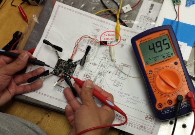

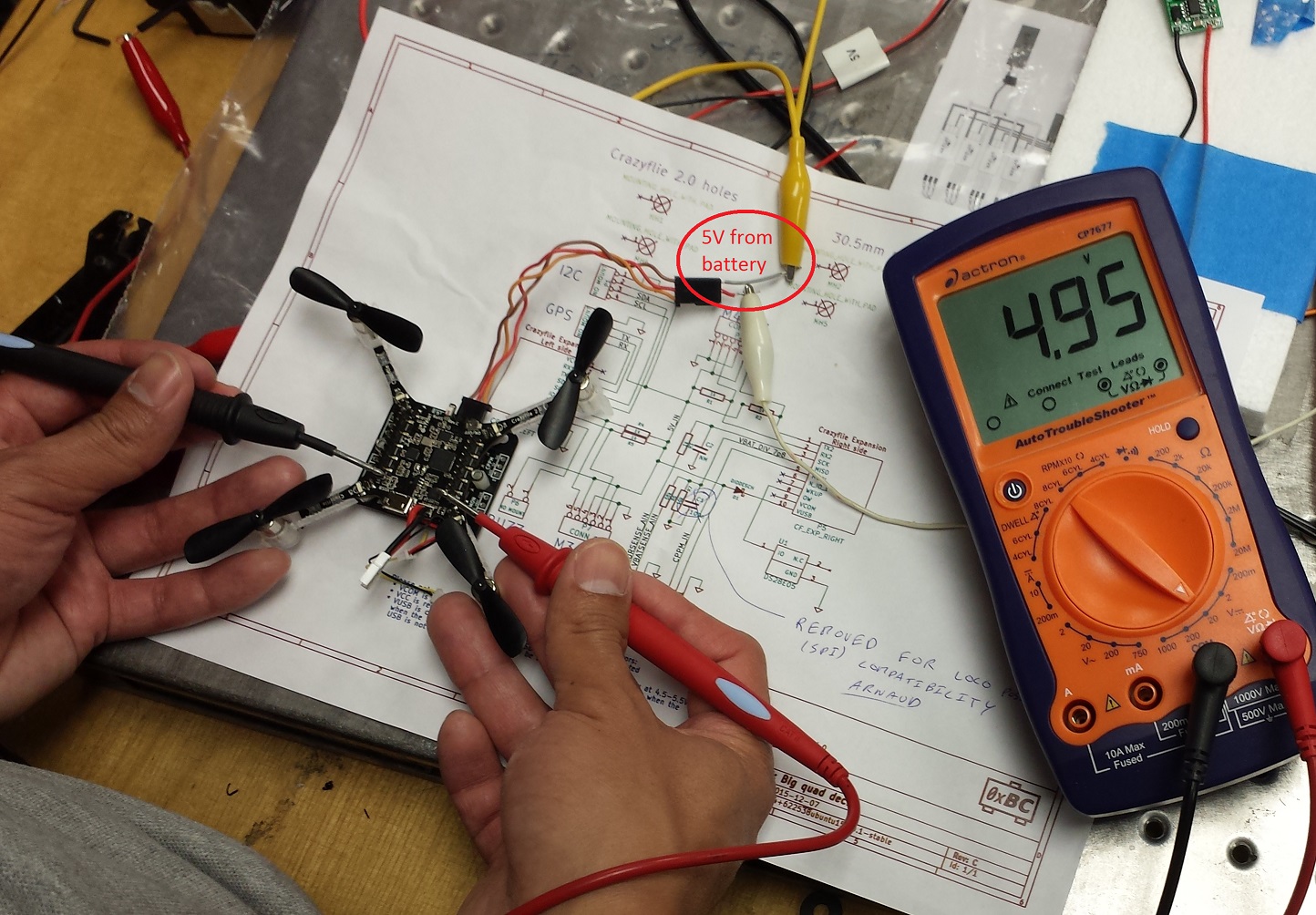

Is it correct that the Crazyflie 2.0 can get power from the Big Quad deck if it is receiving 5V from one of the M ports? We are supplying about 5 volts from an external battery instead of attaching an ESC. We are not connecting a 3.7V battery to the Crazyflie.
In this configuration, the Crazyflie does not turn on. But I measured the voltage of VUSB and my meter reads 4.95V, so the Big Quad deck is getting power?
I attached a photo. Thank you for helping us!
Re: Firmware Update: Motors Not Spinning
Yes the CF2 can be powered from the BQ-deck with 5V. When mounting it the wrong way there is a possibility that something might break but we haven't managed to do so during our tests.

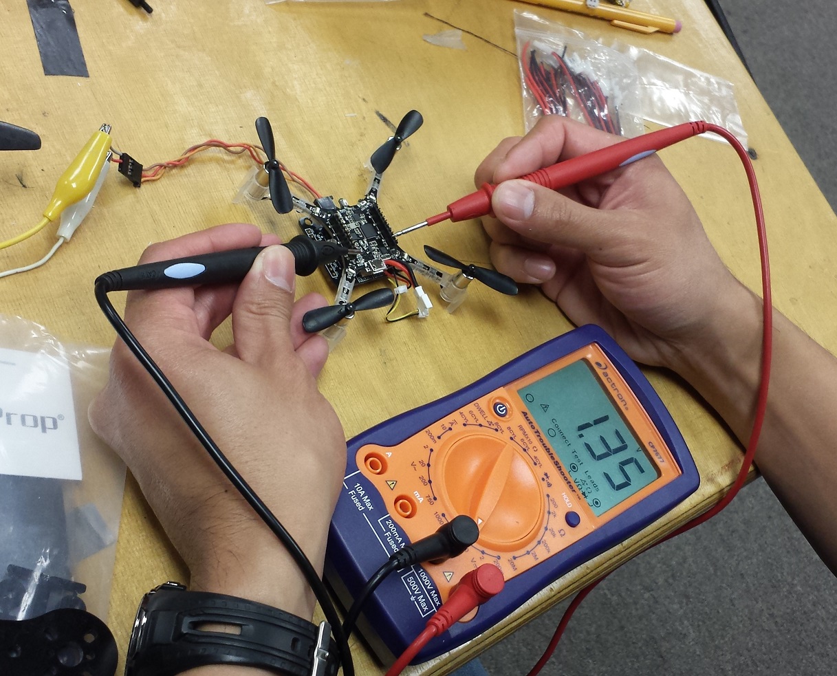

But when we attached the big quad deck with a 5V supply connected to M4, the crazyflie cannot turn on, so we cannot connect the cfclient to it. In this configuration, the voltages on the crazyflie are:
VCC = 0.85V
VCOM = 1.35V (see picture)
VUSB = 5.13V
We are using big quad decks that have been modified to be compatible with the Loco positioning system. Is that related to our problem?
Using 3.7V battery, and no bigquad deck attached, and the cfclient communicating with the crazyflie, the voltages were the same (VCC = 2.9V, VCOM = 3.69V, VUSB = 2.63V)
VCC = 0.85V
VUSB = 5.13V

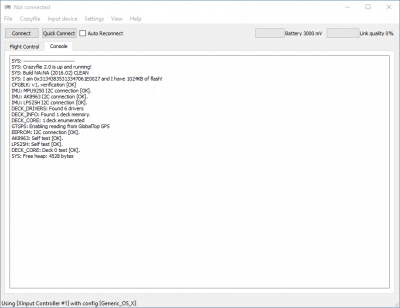

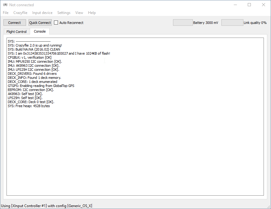

I'm currently using a new CF2 and everything is working well, the VUSB works just fine. I just flashed it with the new firmware and here is the photo of the console.
