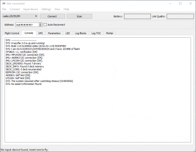

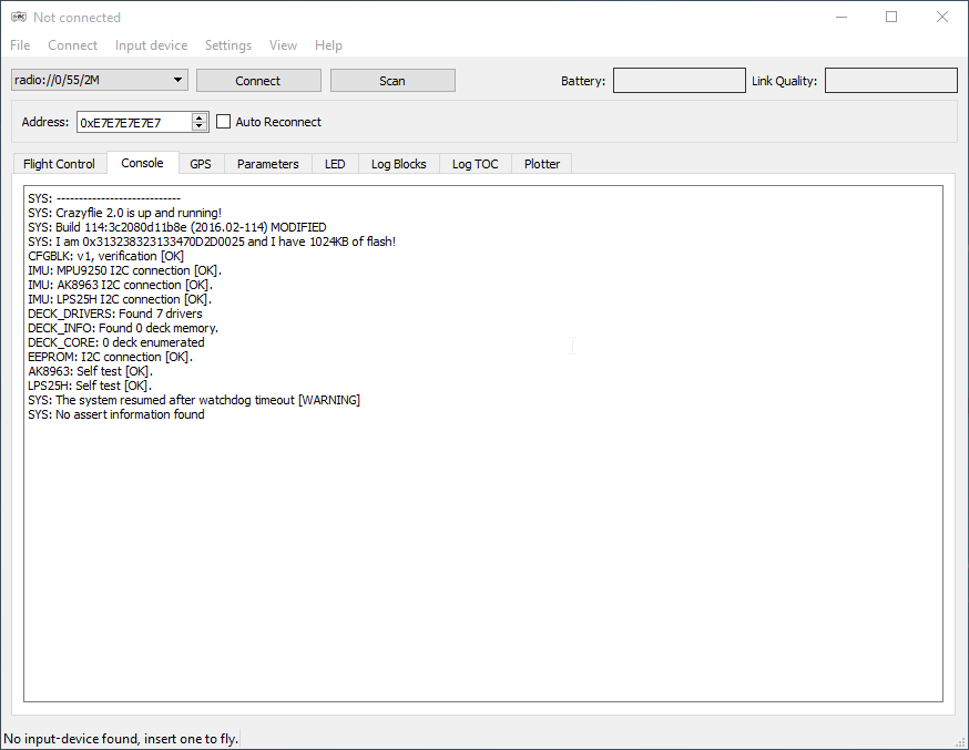

I did enable "CFLAGS += -DENABLE_BQ_DECK" from the config.mk file. Then I did "make clean", "make PLATFORM=CF2", "make cload", before connecting to the crazyflie. I do not, however, see anything about the big quad deck being enabled in the copter console even with the PC. Here is a photo:

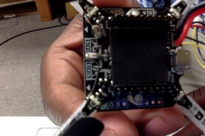

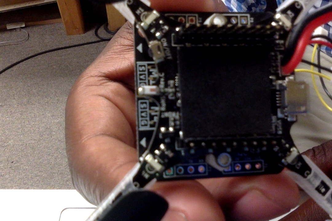

Here is my current problem https://www.youtube.com/watch?v=nd0CQtDnuqQ. With this problem, I can't connect to the crazyradio on the computer (Windows 10 or Mac).
Re: Firmware Update: Motors Not Spinning
For some reason the bigquad board hasn't been detected and looking at the video I can see that the CF2 is mounted the wrong way around. Turn it around 180 degrees and it should work.
The other problem you are seeing is because the battery isn't connected and as the USB has current limiting it triggers a reboot. But then again turning the CF2 around probably solves all the problems.

So should the front of the CF2 be directly above the arrows on the big quad deck or the other way around?
Also, for some reason, the CF2 is only showing a solid blue light when turned on. What should I do to fix that?

Yes exactly, the arrows should point to the front.
So if you disconnect the bigquad deck does the CF2 power up correctly? What happens when you push the on/off button? Have you connected anything else to the bigquad deck?
