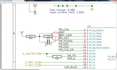

May I know if NRF51822 Pin 6 is connected to R25 100K in the crazyflie2.0 schematic? I have marked it in the attached jpg. Thank you.

Yes it is. Thats the sink pin to let the current flow through the resistor. This should remove unnecessary power consumption if the system is turned off.

Thank you
