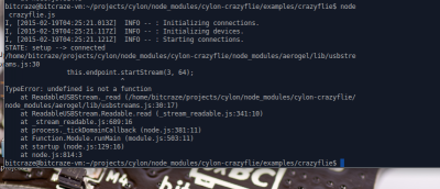

When I'm trying to Cylon example in VM.
The same error occur.
