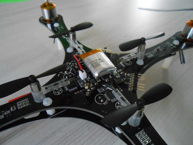

Just posting some pictures from my test setup I'll be using for development. Frame from hobbyking
CF Brushless frame2.JPG (97.67 KiB) Viewed 19123 times
CF Brushless frame.JPG (115.9 KiB) Viewed 19123 times

Re: Brushless Controller
Post by DesTinY »
:o That looks so Wonderful. I love it! :lol: :D
And huge opportunities!

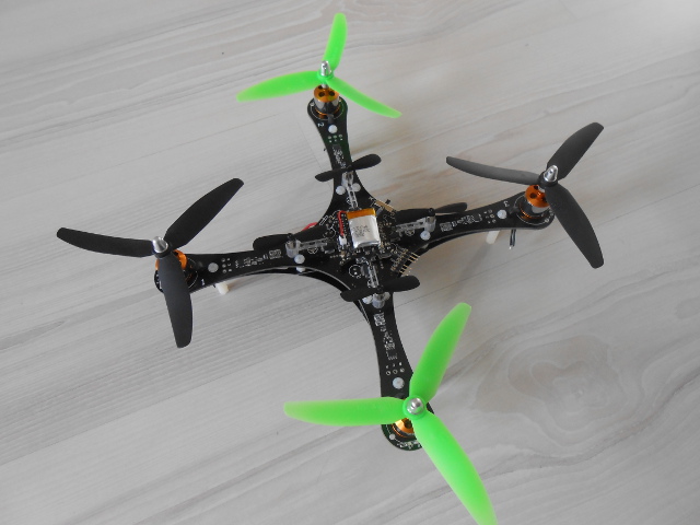

As I have posted in the blog we have successfully flown a bigger quad using the Crazyflie as control board. Be aware that this is totally experimental though and if might be wise to make sure you have a good radio link before anyone tries it out. Also we flashed the PCB frame BLMC with the SimonK firmware and I'm not so sure this is working 100%. I actually managed to put two of the MOSFETS on fire while testing them by stalling one of the motors.
The brushless driver can be activated by defining BRUSHLESS_MOTORCONTROLLER and is available in the brushless_driver branch. Don't flash this on a regular Crazyflie with then stock brushed motors as it will turn them on at full speed when it is started. This because the signal is inverted for the brushless driver.

I got a request about motor setup.
What I use is these motors as they actually fit into the mounting holes of the frame which the HK suggested ones didn't. I used these 5030 3 bladed props.
