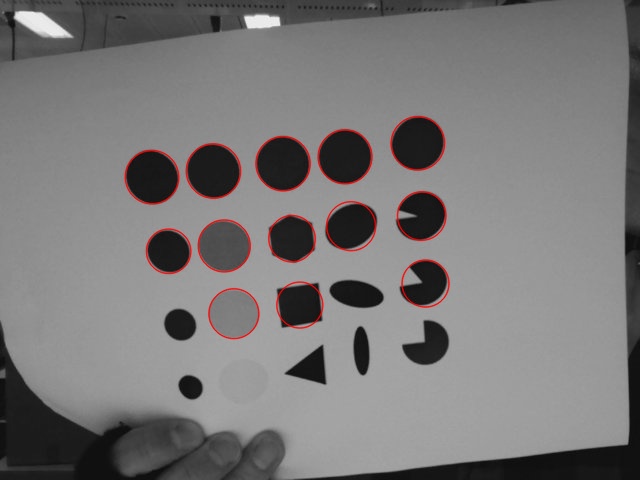

After some more experimenting and understanding the differences between older and newer versions of the various libraries, here is some example code that takes a picture from a webcam (you could presumably have more than one as video0, video1 etc), and then scans this for "blobs", and prints out the coordinates of the blobs.
So this could be used a a simple tracker for CrazyFlie if it has a suitably high-contrast "blob" stuck to it. Since this runs in Python 3, you could now add mc.commander code etc to control the CrazyFlie from the same script and run it from IDLE 3, etc.
I am just putting this code snippet here for the record to show the libraries and syntax needed for some of the commands. For instance the pillow (PIL) library is needed, even though, as far as I can see, no PIL commands are used... I don't understand this either! I stumbled upon this when trying to use PIL to display an image captured by cv2, just to prove that cv2 was even working.

keypoints = detector.detect(im)
# Draw detected blobs as red circles.
# cv2.DRAW_MATCHES_FLAGS_DRAW_RICH_KEYPOINTS ensures the size of the circle corresponds to the size of blob
im_with_keypoints = cv2.drawKeypoints(im, keypoints, np.array([]), (0,0,255), cv2.DRAW_MATCHES_FLAGS_DRAW_RICH_KEYPOINTS)
# Show keypoints
cv2.imshow("Keypoints", im_with_keypoints)
cv2.imwrite("with keypoints.jpg", im_with_keypoints)
