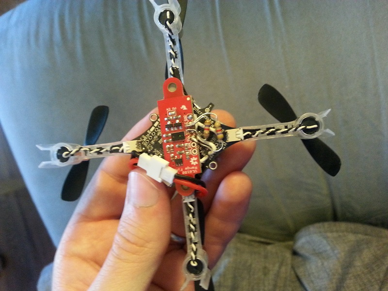

I also have a crazyflie 2.0 and want to integrate a VL6180 sensor for continuous height measurements to achieve a controlled hover about 4 inches off of the ground. I have attached the sensor application guide which explains how to perform a continuous range measurement and I think the routines that can handle this in the crazyflie firmware are i2cdev.c and i2croutines.c but I assume they need to be modified. Am I on the right track? I'm definitely not an experienced programmer.
Also, it appears you can directly connect the sensor as follows: VCC to VCC, GND to GND, SCL to PB6 and SDA to PB7

I have attached a picture of my flie with the sensor installed

Your hardware wiring should be fine so it is now all about the firmware and that is where it might get a bit complected. I guess the easiest way would be to port the arduino driver to the Crazyflie platform. Use eeprom.c as a template/guide to put in the vl6180 driver code. Basically what you need to port is the code that uses arduino wire (i2c) driver, make it use i2cdev instead and make it c instead of c++.
