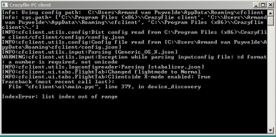

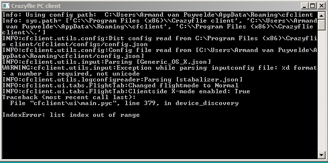

Crazyflie PC client doesn't recognize controller Sony dualshock 3 (see attachment). Perhaps can somebody tell what it means and what tot do?

Could you try to delete/un-install the client and update to the latest version that we released yesterday? The source/binaries can be found here.

Thanks, it works! Allmost, it's hard to fly. How to stabilize the fly, while using Trust only?
