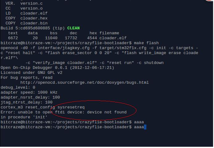

I want to burn bootloader for crazyflie,my steps as follows:
1.use a JTAG connect to the crazyflie's JTAG port
2.use VM terminal,and then input
cd ~/projects/crazyflie-bootloader
make
make flash
but it comes some error like this

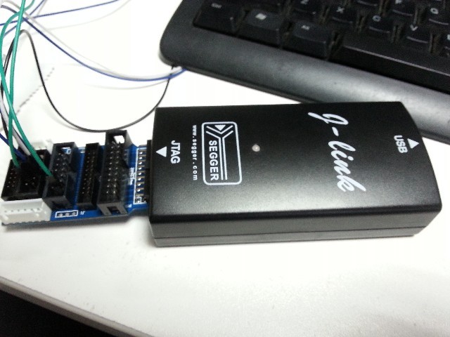

my JTAG like this:
why it comes?Is my JTAG's problem?

You need to define the right programmer interface to OpenOCD. Since you seem to have a JLINK try this:
make flash OPENOCD_INTERFACE="interface/jlink.cfg"

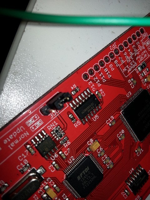

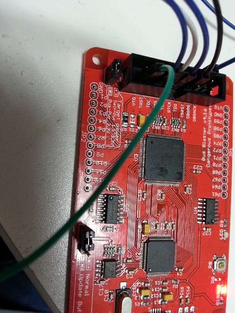

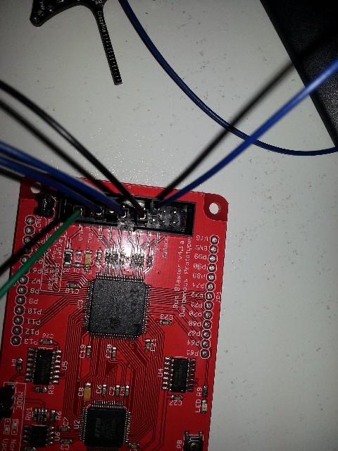

I have bought a Bus Blaster v4 and link it as the picture
I do it as you said ,but it comes:Error: Cannot find jlink Interface! Please check connection and permission.
Posts: 1919
Re: Crazyflie bootloader
Post by tobias » Fri Oct 25, 2013 12:00 pm
If you now have a bus blaster you need to specify openocd to use that interface.
make flash OPENOCD_INTERFACE="interface/busblaster.cfg"
