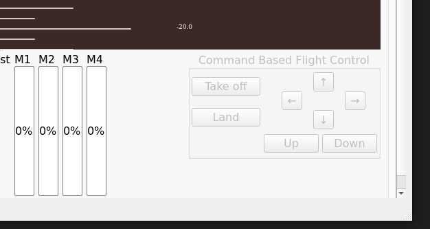

Could you perhaps get the newest version of the client? And try the new flight controls in the flight tab that uses a command based way of flying. It sends simple commands like "take off", "land" "go left" "go right" "go up", etc.
You can install newsest client using python pip3 or from release page:

Other interesting tests would be to check:
1/ Does it fly well without the flow deck?
2/ If you lift it up with the flow deck mounted and move it around a bit, does the X, Y, Z at the bottom of the flight tab in the client change accordingly?
