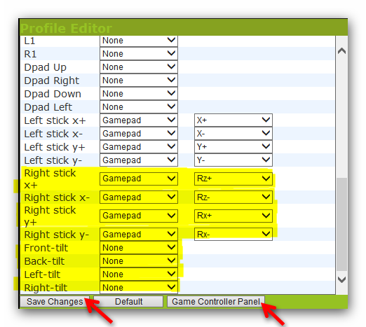

I got the right stick working after making a own profile in MotioninJoy:
create own profile
create own profile
Snap_2013.05.09_22h58m19s_002_MotioninJoy Gamepad tool.png (130.64 KiB) Viewed 18664 times
I set the setting as you can see here:
settings 1
settings 1
settings 2
settings 2
The important parts marked yellow. In this settings the tilt sensors are disabled because i don't need them. After creating the profile make sure you choose it for the controller in MotioninJoy and test it with a click on controller configuration -> advanced. If every stick / button is working open the CF PC client and configure the mapping as you want.

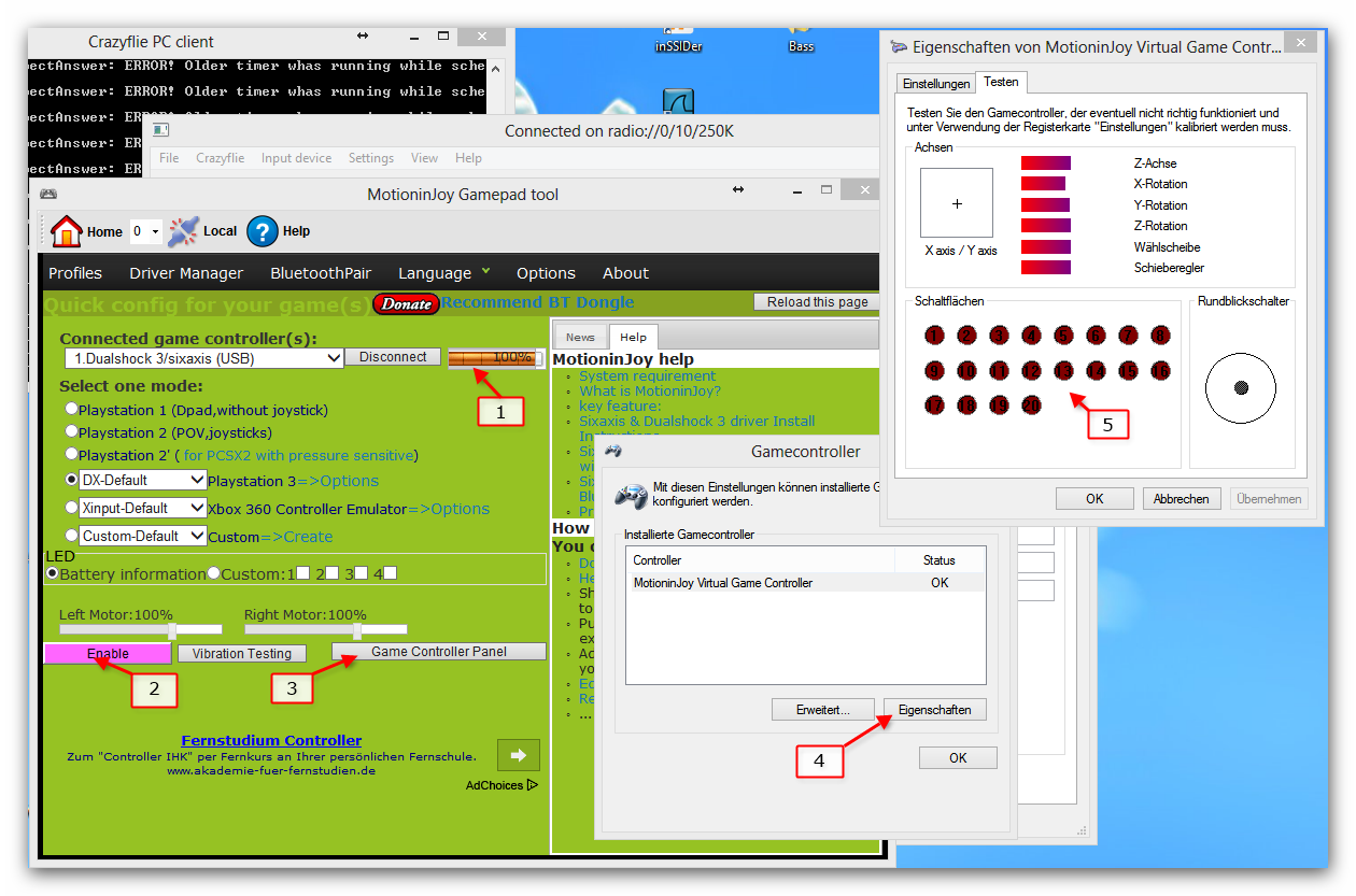

For the How To i updated my MotioninJoy to version 0.7.1001 and i'm using the driver 0.7.1001. To Update MotioninJoy went to the "About" section and clicked "Check update". To test the default configuration i connected my controller via the Driver Manager in MotioninJoy and testet if every button and stick is working:
Step 1: test if every button / stick works
  • 1: the controller is connected successfully
  • 2: click "enable" to set the mode to the controller (to make shure the setting is really set clkick it several times, i had some issues with that in the old configuration i used)
  • 3: click on "Game Controller Panel"
  • 4: click on "Properties"
  • 5: push every button on the controller and move the sticks in any direction, check if you can see every action you do in this windows
If everything work till this point so far so good, lets go to step 2.

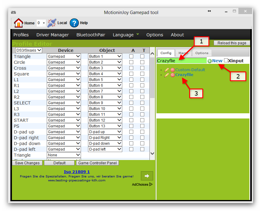

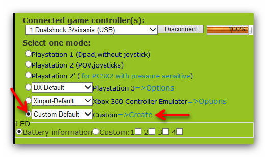

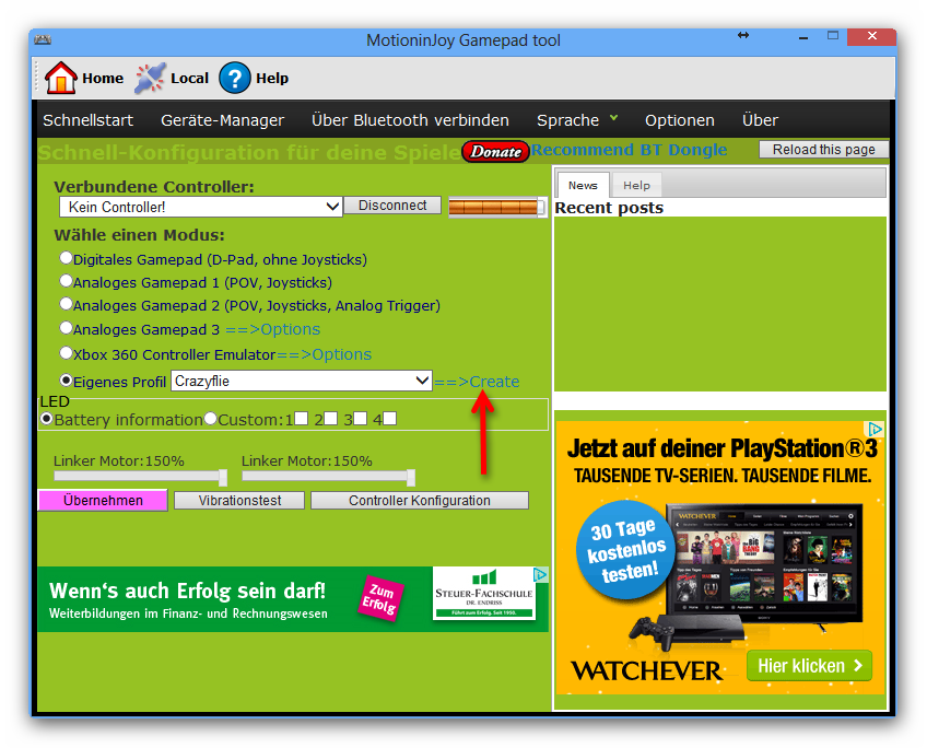

Now i created a own mapping in MotioninJoy. Set the radio button to "Custom-Default" in MotioninJoy and click on "Create":
Step 2: click "Custom Default" and then "Create"
Next we create a own mapping, i called it "Crazyflie":
Step 2: create a own mapping
  • 1: name the mapping
  • 2: click on "New"
  • 3: make sure the new mapping is selected (it's a little bid bolder then the other one)
HOW TO CONTINUES IN NEXT POST!

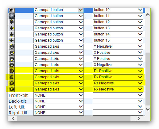

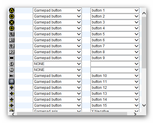

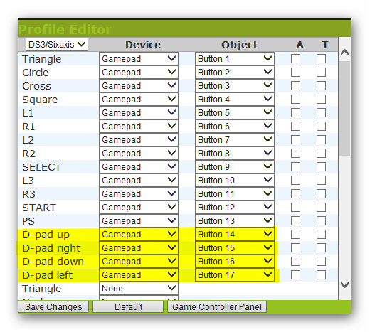

Now i changed the necessary parts in the profile editor, you can see it in the screenshots , the yellow marked parts edited by me, the other ones are default:
change mapping 1
change mapping 1
change mapping 2
change mapping 2
After changing the mapping click on "Save Changes", check the mapping again with a click on "Game Controle Panel" as you did in before. If any stick and button works click on "Home" in the top left.

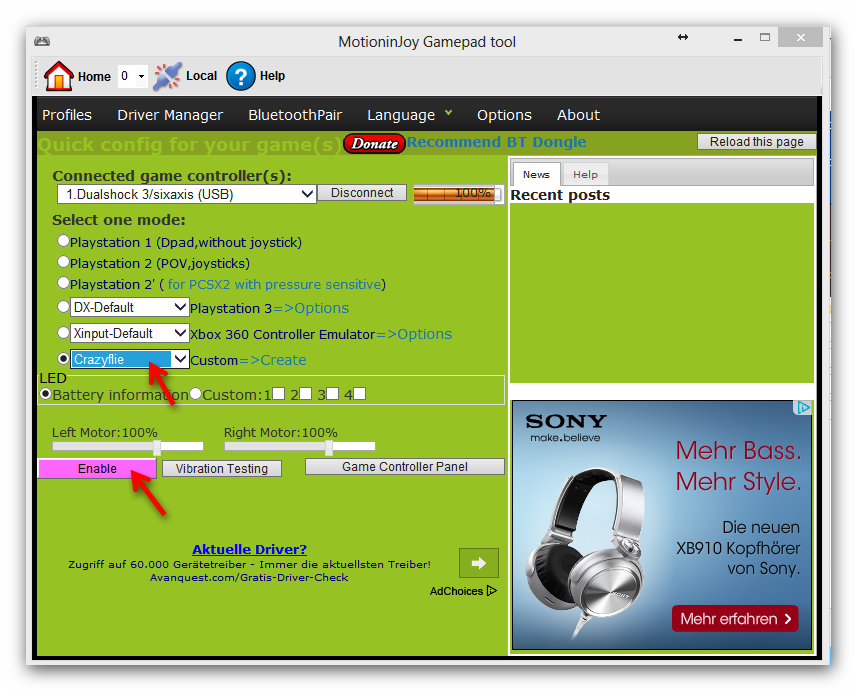

Now choose your mapping in the dropdown menu "Custom" and click "Enable" several times:
enable the settings
enable the settings
Thats it!
If you now open the CF PC Client and configure your own key mapping in the Crazyflie Client the right stick should work. If it doesn't works for you please answer to this thread, i'm sure we can find a solution for everyone.
