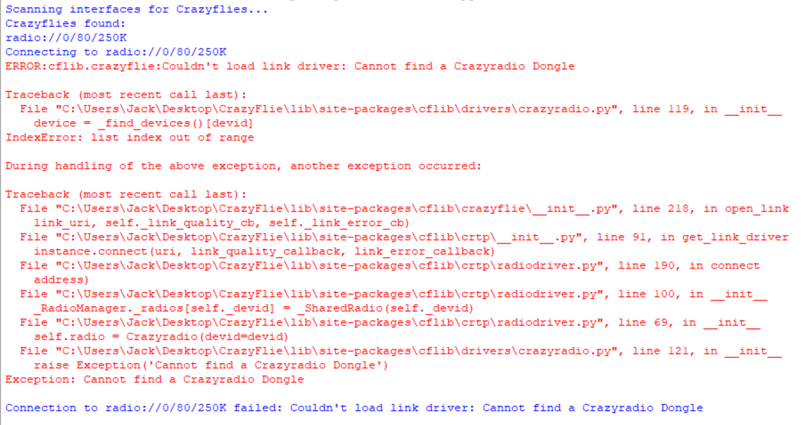

Finally, and most importantly, when I attempt to run either example (basiclog.py or basiclogSync.py), the process of attempting to connect to the Crazyflie outputs an error saying "Cannot find a Crazyradio Dongle." This confuses me because the Crazyradio works perfectly fine when executing the flight examples, but evidently not while executing the logging examples. This is why I asked about the difference between using the specific URI to connect to the Crazyflie in comparison to using "cflib.crtp.scan_interfaces()" to scan nearby drones. There must be some difference between the flight examples and logging examples which causes the radio to properly function on the former but not on the latter. Any idea what this could be?

Managed to get the sensor data printed by replacing all instances of 'available[0][0]' with 'URI'. Am now working on writing it to a file.

The cannot find crazyradio dongle is indeed surprising, was it from unmodified example? If so, this is a bug.

The "cannot find a Crazyradio dongle" was the output from both the basiclog.py and basiclogSync.py. I managed to make it work by connecting using the URI, but yes it was strange.
