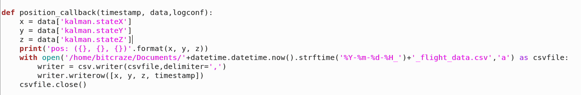

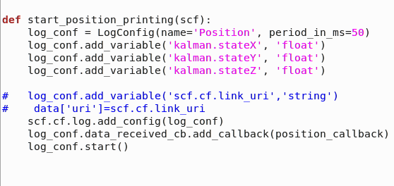

Hi, I am using python to run the crazyflie. And I was using those code to get the position information of the crazyflie. And the data I got were the data from all of the crazyflies together and I could not classify them, so I just want to know how get the uri information for each data I got.

you need to setup a different log callback for each Crazyflies or to add a parameter to the callback with the ID of the drone. One way to do that is for you to create one logger object per Crazyflie, this way the object state can contain the ID. Another way would be to have a lambda function that adds the ID to the callback call. We have used the lambda strategy in many places in the client if you need some examples.
