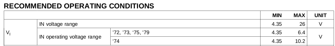

I remove R24 and R18 for safety. Then when I tried to increase the VUSB from 5v to 7V (no battery), the output of BQ24075 (voltage on R17) dropped from 5v to 1v. I'm confused about it since the reference manual says it can accept up to 28v of input.
Re: Changing battery voltage
After checking the datasheet a bit more the operating voltage range is 4.35V to 6.4V, thus it will not regulate the voltage above ~6.4V so It looks like it can not be powered by more then that.

tobias wrote: ↑Fri Jan 31, 2020 8:36 am After checking the datasheet a bit more the operating voltage range is 4.35V to 6.4V, thus it will not regulate the voltage above ~6.4V so It looks like it can not be powered by more then that.
OK, I'd rather using a external 5V LDO instead.
