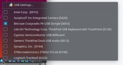

As for the connection to the VM, do you see the Crazyradio in the USB menu on the bottom and is is passed in the VM? I attach what it would look like on my machine:

Thanks for the reply. I was mistaken, it does flash green and red when plugged in. However, the crazyradio is recognized in the VM. Whenever I hit scan in the client, it does not recognize that the radio is plugged in, and displays the message that I provided in the original post. Do you think that this is still a firmware issue?

If both red and green LED lit up upon connection and you see the Crazyradio in the list of VirtualBox device and manage to click it to enable it in virtualbox, then it is very likely that the radio firmware is going well.
