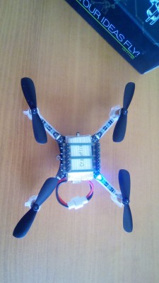

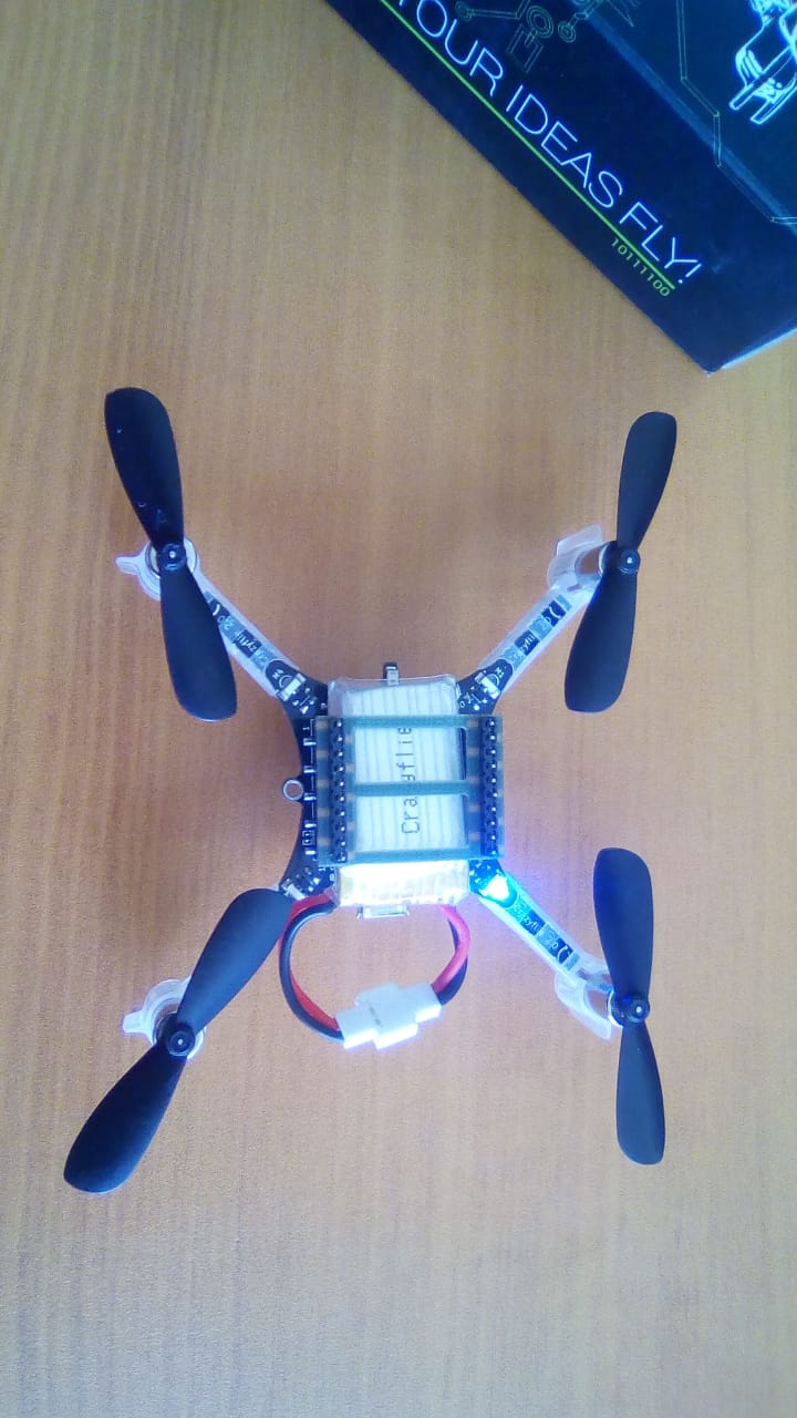

I deleted the charging mode using the Keil uVison5 software, accidentally pressed delete and when I did it only the blue LED of the M2 was on and since then, this happened using the JTAG
Since then I have not been able to fly the crazyflie, I have tried to load from the Bitcraze VM with eclipse but I do not have good results
Thank you

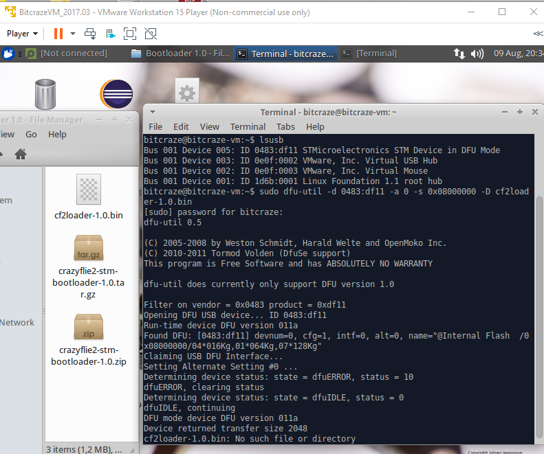

Yes, I hope that only STM32F4 has changed, when I put the cfrazyflie in DFU mode and enter the VMbitcraze command window the following mistake appears (image)
The crazyflie2-stm-bootloader-1.0 folder is on my desktop, this file is necessary to run it in eclipse or what is its correct location?
