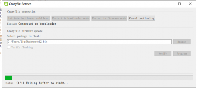

by the way, I'd like to mention that it is possible to flash cf.bin directly via cfclient , instead of generating total zip flie.
- during flash

by kimberly
Yes that is also possible. This only works for the STM32 though. For the NRF51 you still would need to use the zipfolder.
