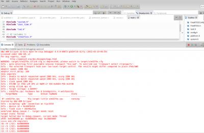

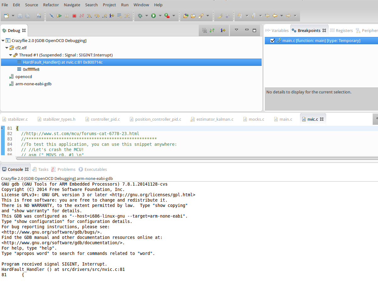

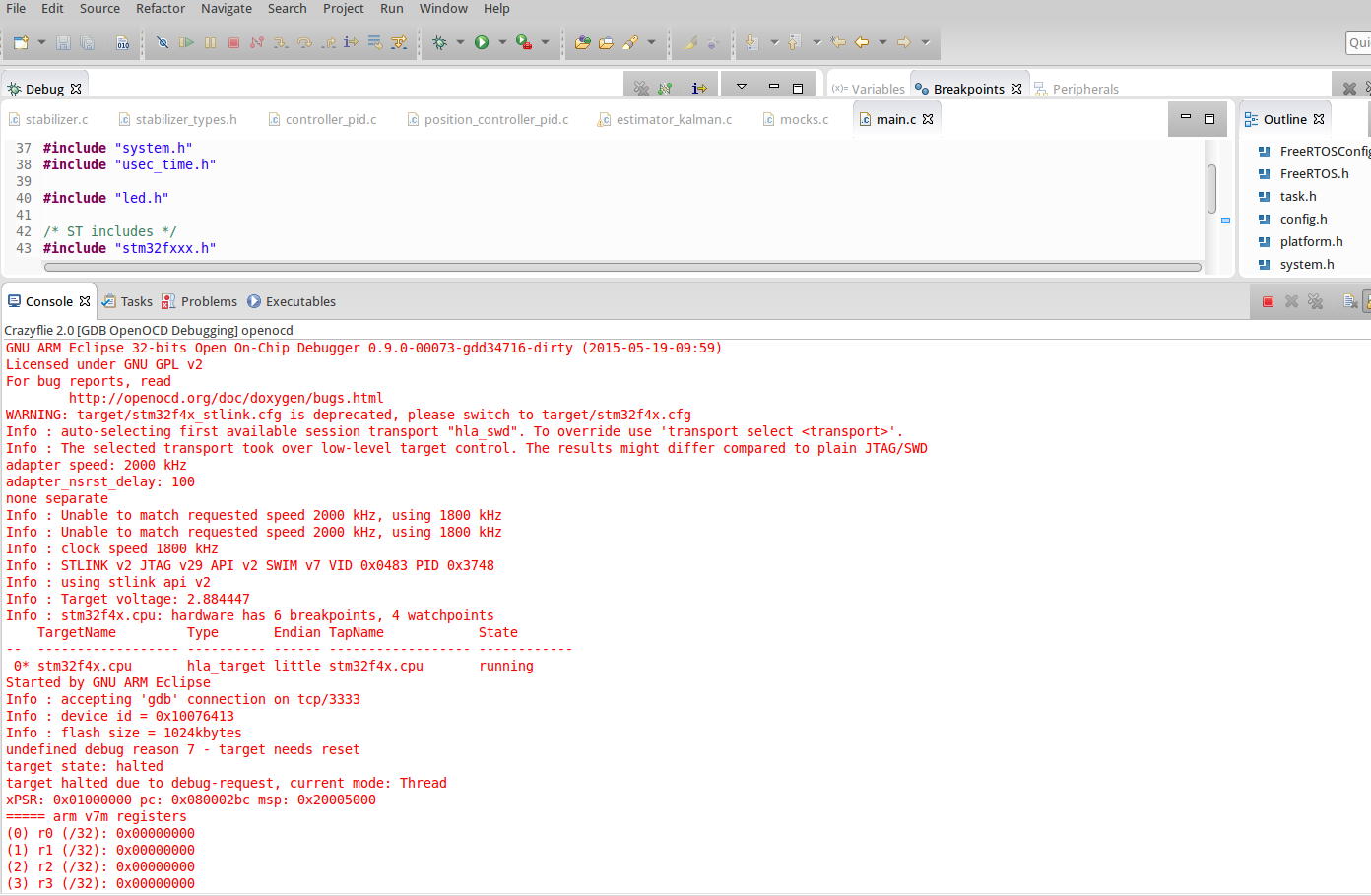

I recently ran into a problem while debugging crazyflie with stlink. I followed the procedure: “To start debugging go into the "Run -> Debug configurations..." dialog and under "GDB OpenOCD Debugging" I find "Crazyflie 2.0". Press the debug button”.
It should start the debug and hit a breakpoint at main, but it didn't. The eclipse interface is shown below Fig. 1 and Fig. 2. I don't know what the problem is. But I've done it before, and it stops at the break point of the main function.

You entered the Hard fault handler before reaching main. Probably because you flashed a bad FW.
