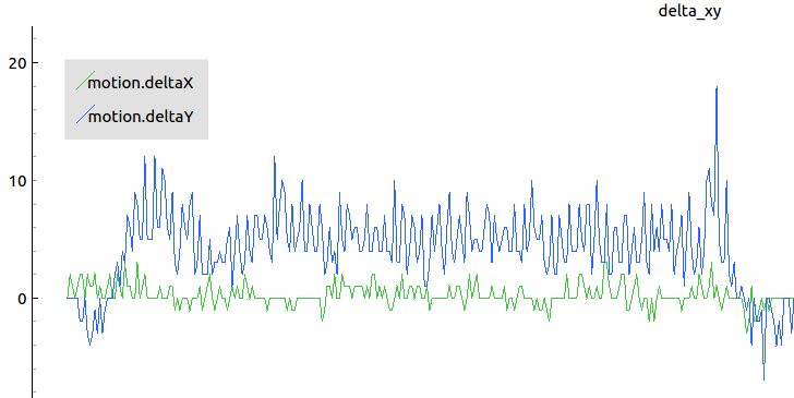

For the Crazyflie, using the flow deck which is based on the same sensor, we are getting measurements that oscillate between a count and another. Here I flew the crazyflie in velocity control mode and I made it fly in a constant velocity for a while: My assumption is that the sensor is somehow accumulating movement and updating the delta by batch and since we are reading the delta asynchronously we get different count depending of when we are reading. So the instant reading is wrong but if we accumulate the delta we read, the accumulation is accurate.
In the Crazyflie we are not using the delta count directly to measure velocity, it is pushed in a Kalman filter together with other sensors, this allows us to get a smooth velocity estimate.

Thank you for your quick reply, arnaud. One of the difficulties of our control system is that it's cycle time of 20 msec varies quite a bit, by as much as +/- 5 msec. So during one test I divided the delta X counts by the actual time step to see if that would explain the inconsistencies. It didn't. There was no correlation between the timestep variation and the readings, except for what you would expect for the normal readings.
As I look at your graphs, I see what appears to be a normal noise signal, with readings that vary above and below an average midpoint. That's not what we are seeing. I will post a graph later today if I can get one off the robot. But for now, imagine your delta X graph raised to about 100 counts. Now imagine that every fifth reading is about 60 counts. It might be the fourth reading in a row, or sometimes the sixth reading, but it averages to every fifth reading. At first I thought we were dropping a bit (2^5), but that didn't check out. I don't have a logic analyzer to watch the SPI bus, so all I can do is deduce from the readings.
