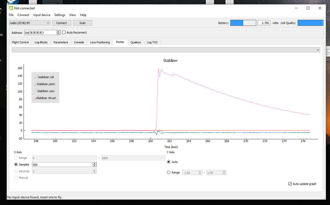

However, I do have two more questions regarding the orientation of the Crazyflie while using the LPS nodes. From what I understand is that one should make sure that the Crazyflie faces the +x direction before running the program/codes as stated in multiple forum posts and guides. Is there a way to make sure that the Crazyflie's stabilizer value is (0,0,0)? Here are some things that might help you understand the problem.
The YAW value stabilizer graph from the Crazyflie client for some reason increases/decreases after turning the drone manually. This is apparent in whatever drone I use. I've uploaded two images of the graph I took from two different drones. Additionally, if I take a look at the "Flight Control" tab from the client, I can see that the drone's stabilizer is moving around when nothing is actually moving it.
