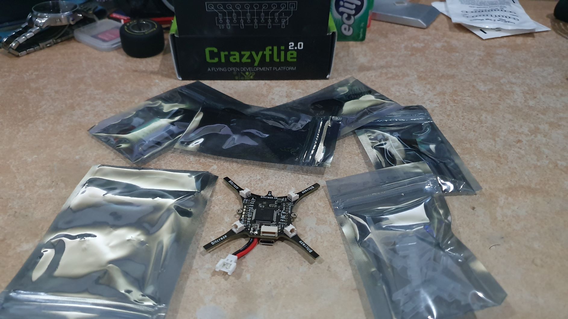

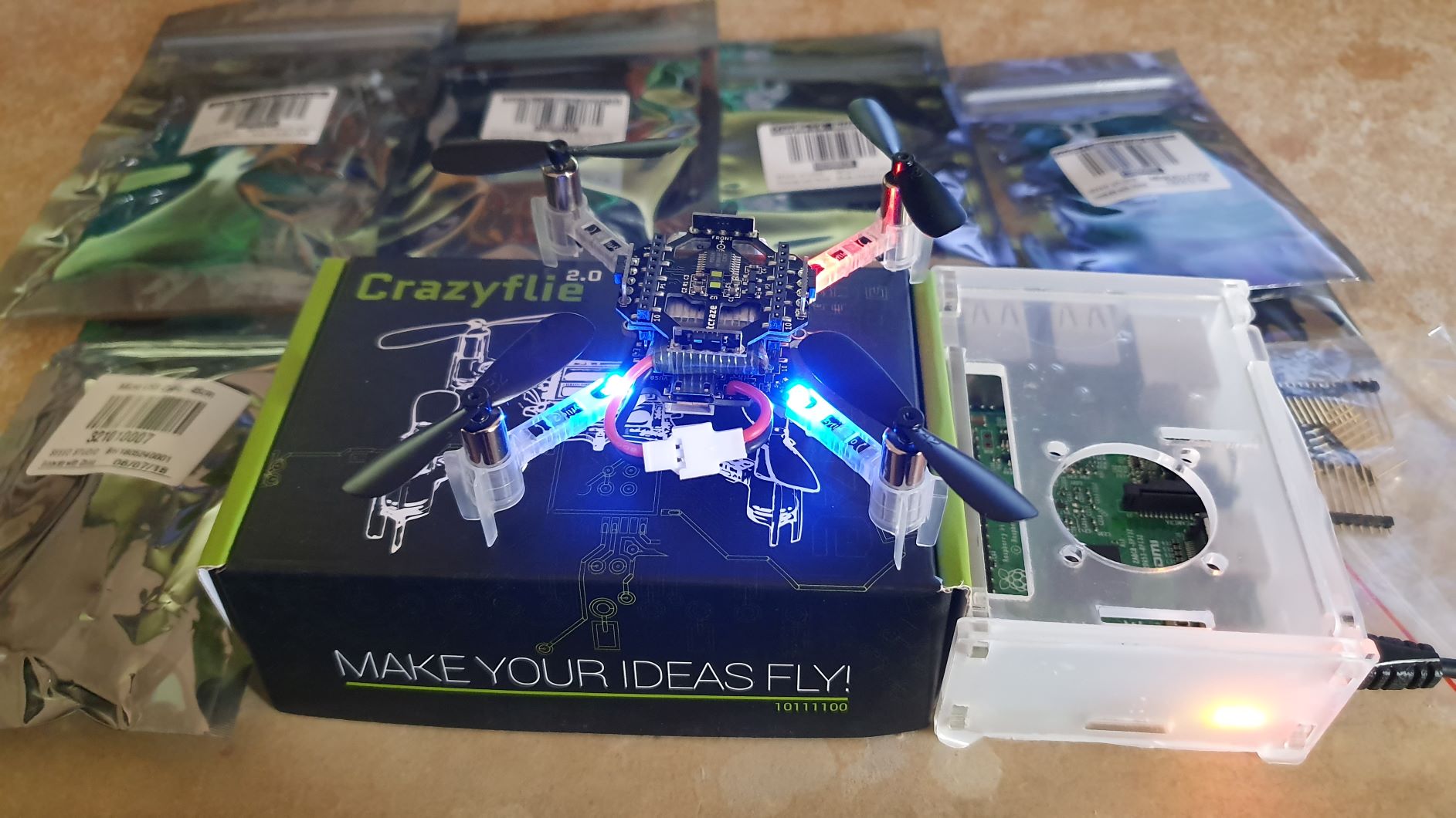

Okay, so I have now attempted to run some of the example scripts specifically for the Multi-ranger deck. Followed the Stem Ranging Bundle walk through (https://www.bitcraze.io/getting-started ... ng-bundle/)and I was able to successfully run the script at the bottom.
I did however notice that at times in the CrazyFlie Client once connected the Flight Data (Attitude Indicator) was not working. This issue was seen intermittently. The error being reported in the console window as follows:
MR: Init left sensor [FAIL]
MR: Init right sensor [OK]
DECK_CORE: Deck 0 test [FAIL]
DECK_CORE: Deck 1 test [OK]
The problem would only come up when I had the Multi-Ranger connected, and so quickly realised that there must be something wrong with the Multi-Ranger Deck. Upon a quick search in the forum came across this (viewtopic.php?f=5&t=3287&p=15928&hilit=Init+Left#p15928). Re-soldered the joints and can now see that the drone can detect objects all around it as expected and required.
