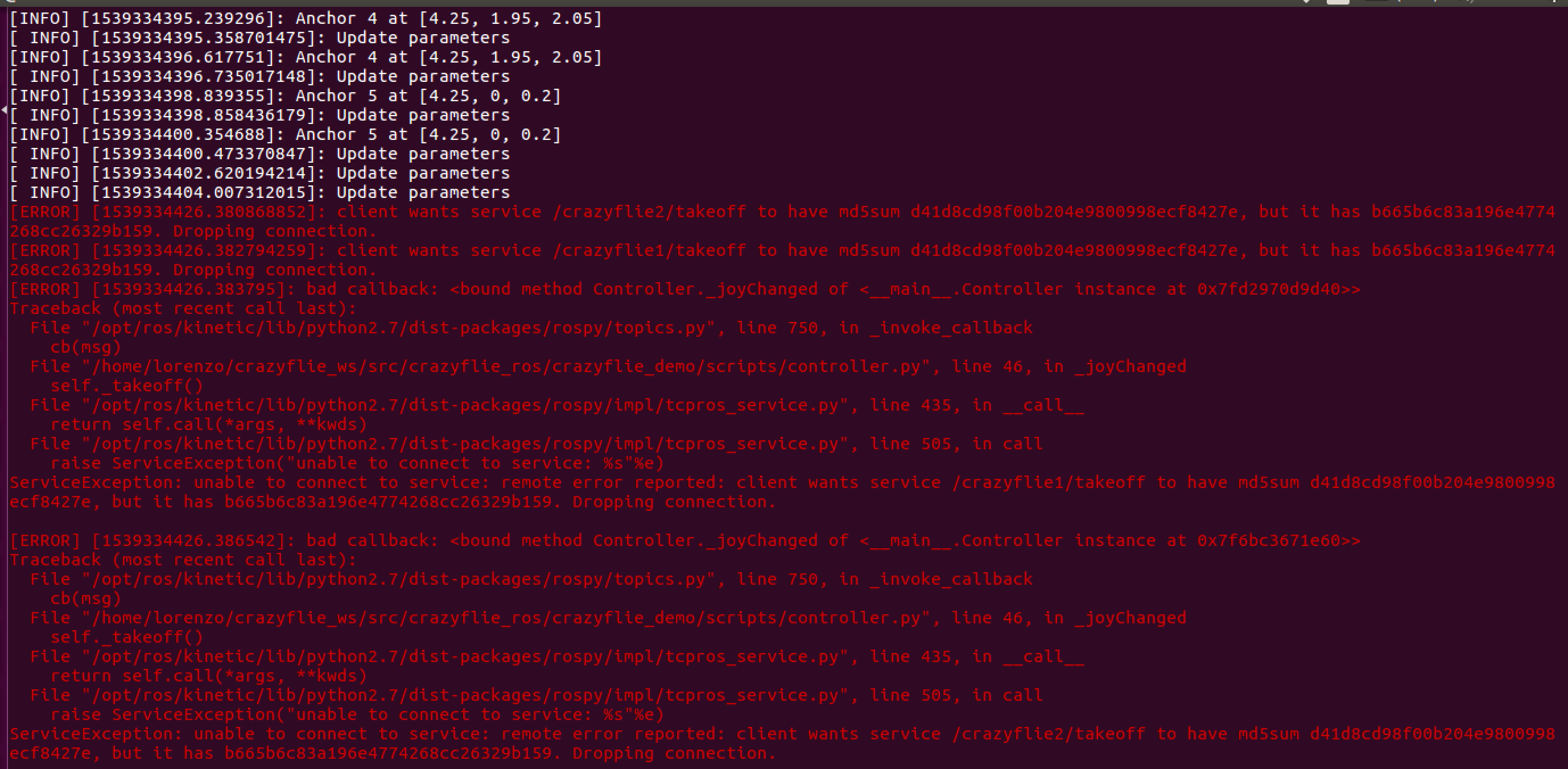

Unexpectedly the result was something like this:
Could anyone help me in find what could be the problem?

There error look like you have not recompiled your ros workspace correctly: the service checksum error appears when the C and Python parts are out of sync. You can make sure everything is in sync by running catkin_make in your workspace root and making sure you are sourcing devel/setup.bash from the right Workspace in all your terminals.

I've already tried to catkin_make the ws in a "clean" way (I've deleted both build and devel directory and I've done catkin_make).
I' ve the following line in my .bashrc:
source /opt/ros/kinetic/setup.bash
source ~/crazyflie_ws/devel/setup.bash
So I think this is correct.
The very strange thing is that with the same: dwm_loc_ekf_swarm_hover.launch with 2 CF's works everything, the issue is when I add the 3rd (and 4th) CF's.
Any other idea on what could be the problem?
Thanks a lot for helping me.

Unfortunately I do not have any more ideas other than the checksum error message should definitely not happen in a well configured and compiled ros workspace. You could try to post a ticket on the crazyflie_ros git repos, they might have an idea of what could be happening.
