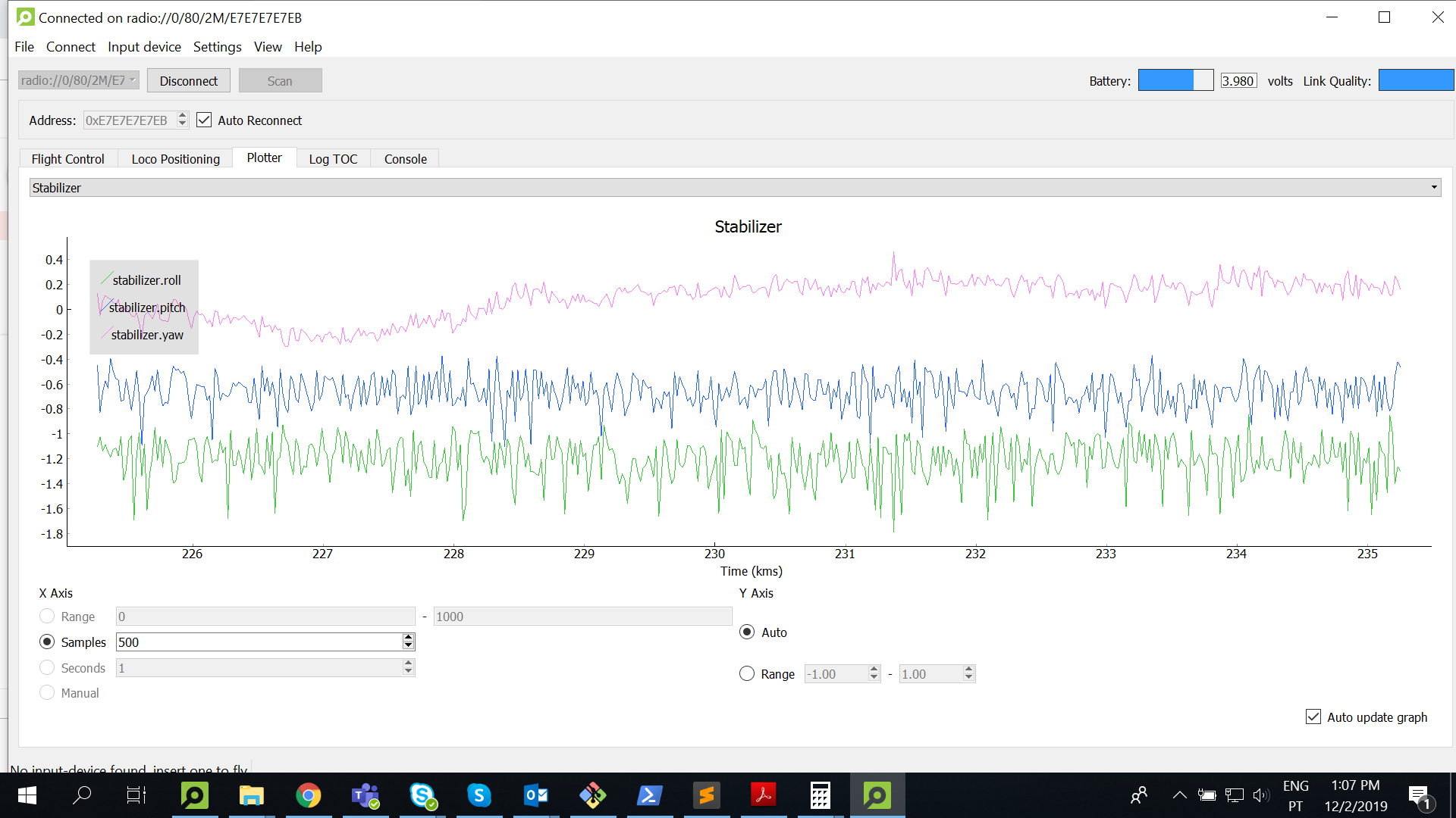

With Flow and Loco i have this noise on the figure "withFlowandLoco.png"

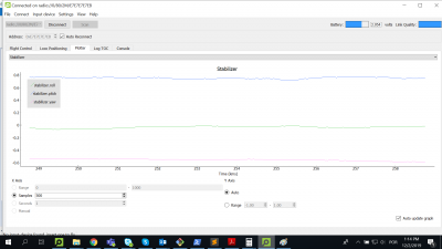

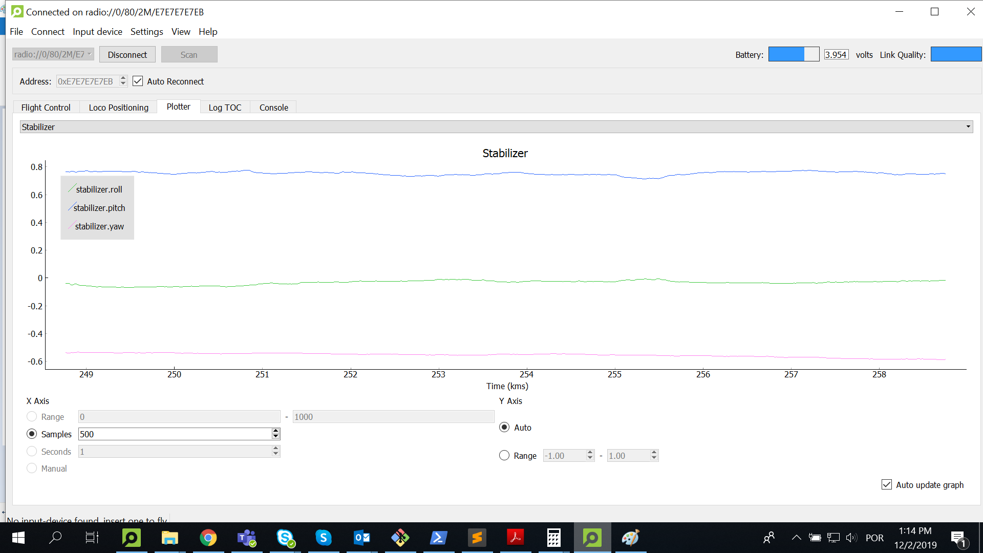

Without Flow and with Loco i have less noise on figure "withoutFlow.png"

This looks like noise from the LPS itself. Do you only have the noise on the ground or also after take-off? The flow should mostly be used by the estimator when the Crazyflie is flying.
