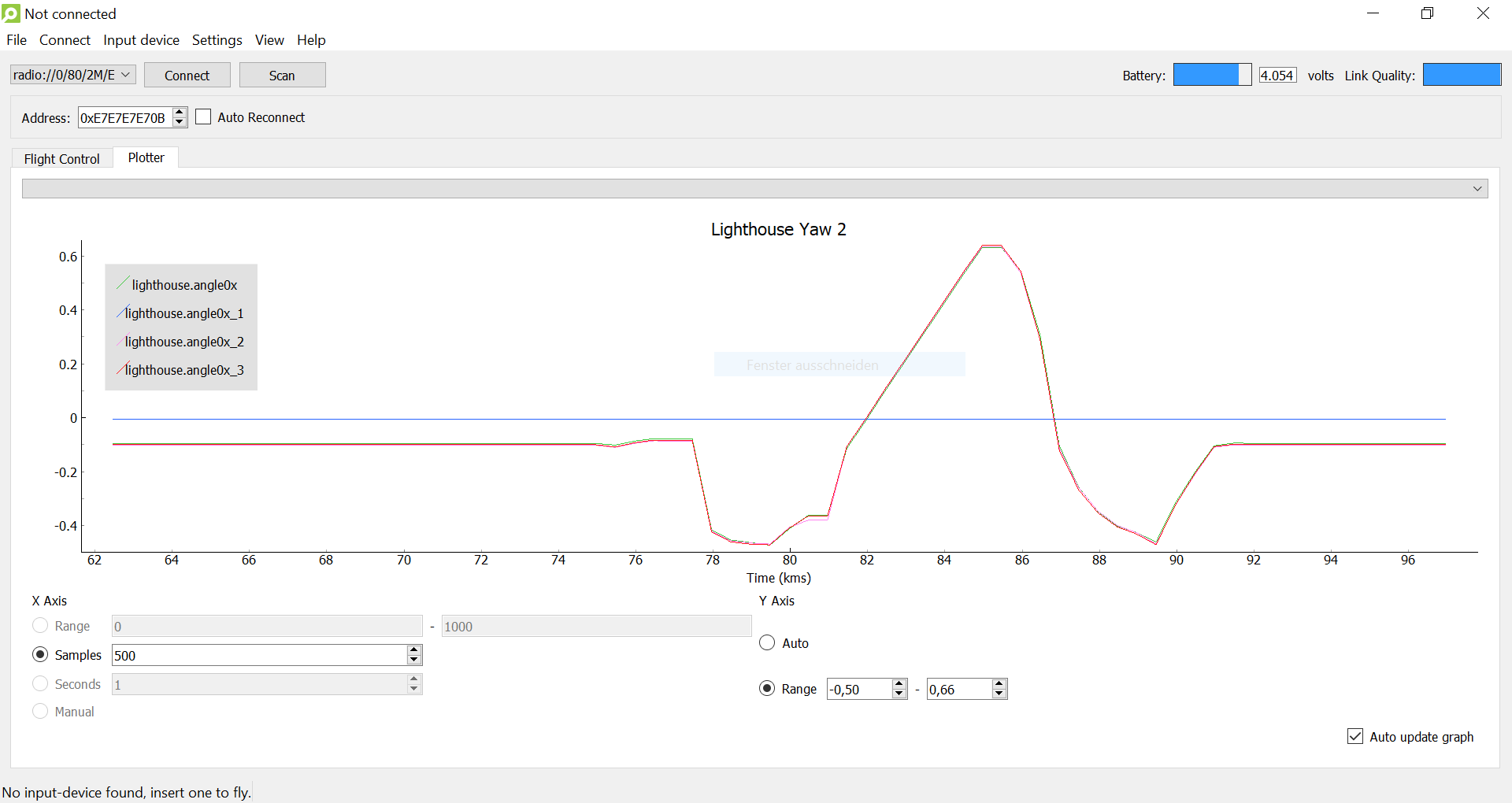

here a screenshot and two videos. To land the drone with the Lighthouse Deck with the offset does not work, because the drone loses its orientation completely with time.

It definitely looks weird. I looked at the code for the yaw estimation and it seems as we are not checking that we get valid data from all sensors, I think this could give the results in the video if one sensor is not working.
If this theory is correct it should be possible to detect by looking at the angle logs for the sensors, I would expect some angles to not change when moving the Crazyflie around in space.
There are 16 log variables , one for the horizontal and vertical sweep angles, for each sensor, for each basestation.
It should be enough to log for one basestation and one sweep direction though. Please set up logs and plot for
lighthouse.angle0x
lighthouse.angle0x_1
lighthouse.angle0x_2
lighthouse.angle0x_3
and check if they all change when moving around.

I'm sorry, but I've only just gotten to try this.
In fact, one value does not change.
This probably means that the decks are no longer usable?

It unfortunately looks like one sensor is not working properly. Please send us an email on
contact@bitcraze.io so we can sort out a replacement for you.
