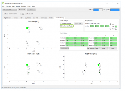

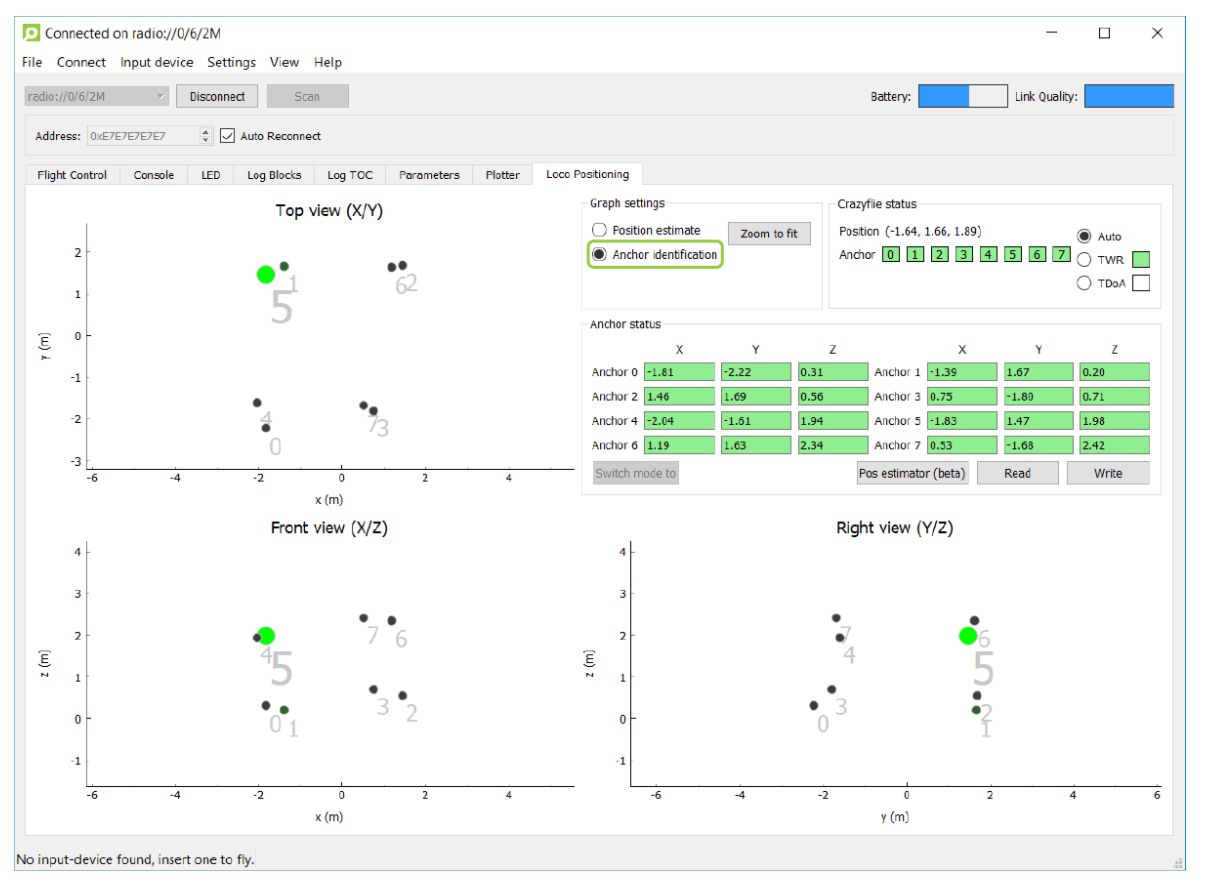

Hi! I have tried to configuring the LPS and everything works well except I cannot see the anchors' status show up on Crazyflie Client as the tutorial from website (https://www.bitcraze.io/documentation/t ... ng-system/).
This is from the website.

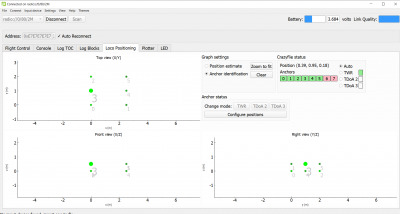

And this is what I got!
Does anyone can help me on this?
Thank you.

The screenshot is from an outdated cfclient. But the status indication is the same.
Under anchors you see 8 numbers in a green or red block. Red means that the crazyflie can't find it, because the anchors is in a different ranging method (TWR.TDOA2 or 3) than the crazyflie, or that it does not exist.
How many anchors are you using in your setup? 6 or 8

Sorry for late reply. At that time, I use 6 anchors. I understand what you mean. I will update the cfclient. Thanks a lot!
