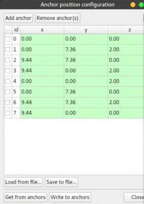

  • An example beacon set-up (from among many others we changed) can be seen in attached lps1.jpg

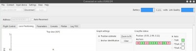

When CFclient is connected with Crazyflie on the ground facing the appropriate x direction; None of the anchors located at ground level is identified as seen in image attached lps2.jpg.
This changes however if we place the Crazyflie at its same starting position but on an elevated level i.e a chair or box. In this case most of the anchors are seen.

I see that it is anchor 0, 2, 5 and 7 that are not visible, they are all at z=0. Are they very close to the floor? If they are, you could maybe try to move them up 10-20 cm?
